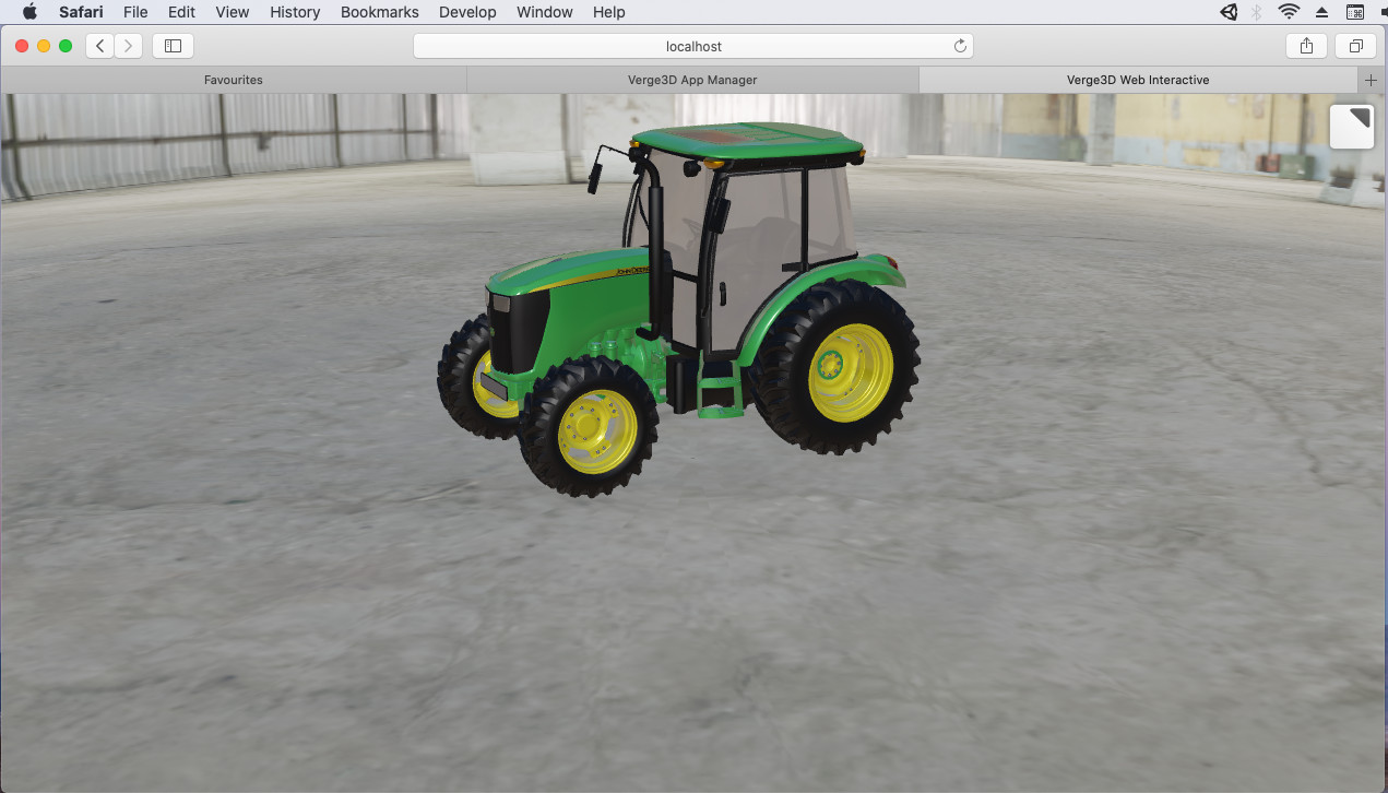

    The link does not load anything and does not show any 3d model. It gets stuck at that point. It gives the above error and one more error, Failed to load resource: the server responded with a status of 404 (Not Found)
    Please check the below link for more details,
    https://demo.realitypremedia.co.in/John_deere_trial%202/John_deere_trial%202.html
    Local output screenshot is attached.
