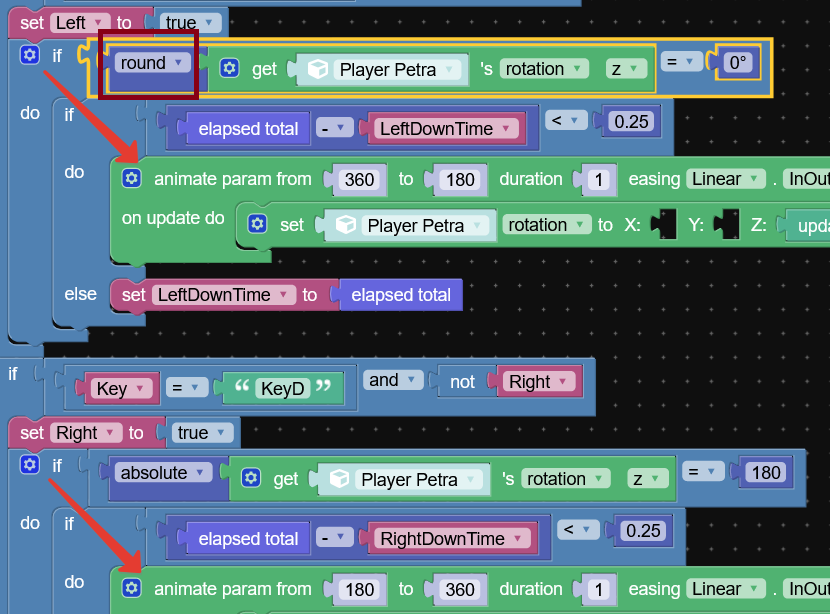

    I did that, it works, unfortunately, it could only rotate facing left and then right. I tried to rotate facing left again, character didn’t do so.
    kurumii
    #67360
    Think. Debug. The answer is obvious and is visible in the console log. Read this topic from the very begining to find an answer.
    #67362
    c4cc
    I simply added “round” to “get Player Petra”‘s rotation as per red box:
    kurumii
    Now I can turn around this character facing left or right side whenever I want. Hell yeah. Thanks for the first tip that mentioned applying that round puzzle to
    kurumii
    #67363
    The miracle has happened.

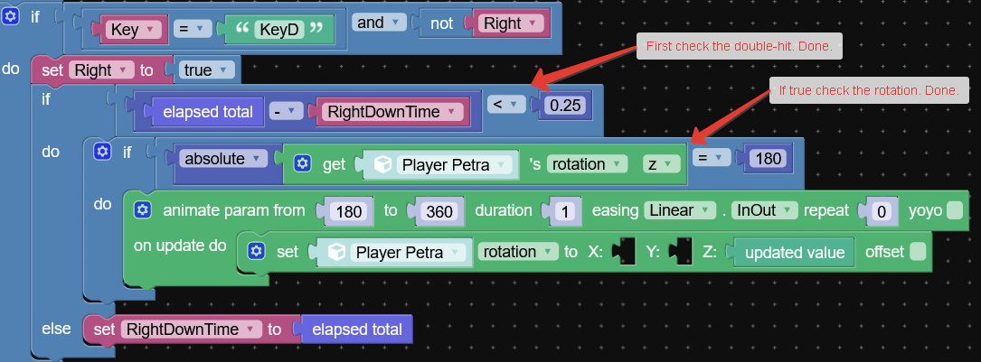

    One more optimization you can do: move conditions comparing rotation into conditions checking the time interval
    First you check the double-hit and if true you check the rotation. That will be a little more correct.

    One more optimization: move conditions comparing rotation into conditions checking the time interval
    kurumii
    How do I do this?
    #67369
    You already did.
    #67371
    c4cc
    What does this mean? If it doesn’t mean click on “if-do” logic puzzles with get Player Petra Rotation Z, then drag it to the if-do-else logic puzzles…
    #67372
    #67374
    c4cc
    Now I finally get it. Appreciate it
    Thanks for this optimization tip, too. :good:

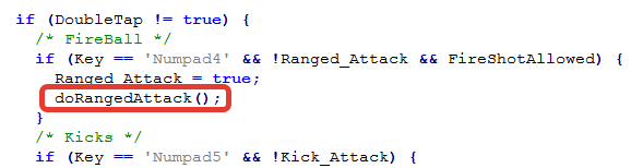

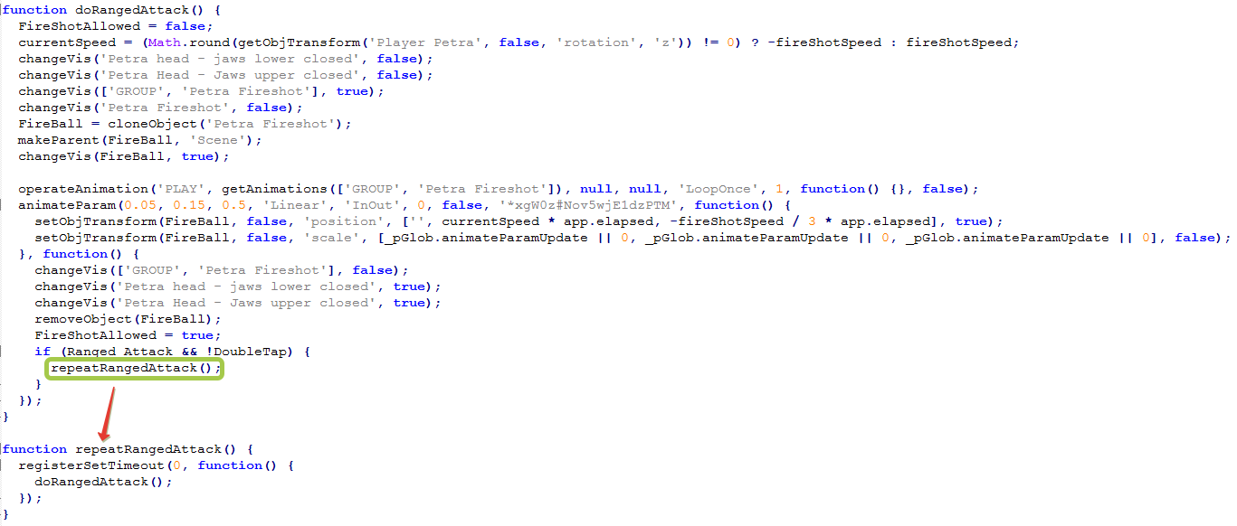

    Verge3d prevent attacks during double tap
    Kick
    original-drawn-by-nanashinayuzu-mochi-53d2788a0d5e217f8b28d256c728bf04
    FireBall

    #68652
    c4cc
    Basic player movements (disabled key input during double tap input)
    #68653
    Any “keydown” event will be interrupted if another button is pressed.
    https://v3d.net/q93
    #68658
    c4cc
    Thanks for the feedback, but my intention was to disable certain key function/inputs during double tapping
