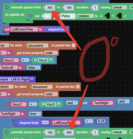

    For context: I was trying to get a character to turn around when certain keys were tapped rapidly twice:
    Key events are responsive before that quick double tapping event,
    but after I double tap keyD (turning left to right), key events are now unresponsive. So how do I
    get key events to be responsive?

    After animated rotating from 180 to 360 the actual final angle is somewhere around -1.4033418597069752e-14 which is not equal to 0. That’s very-very close but not equal to zero.
    Use this puzzle to round -1.4033418597069752e-14 to zero
    https://www.soft8soft.com/docs/manual/en/puzzles/Numbers.html#round
    Or rotate from 180 to 0 instead of 360.

    Rotate from 0° to -180° and from -180° to 0°
    In Verge3D valid angles are in the range -180°…180°. Angles out of this range don’t exist and a special formula recalculates them to be within the range. For example, if you rotate your object from 0° to 240° the final angle will be -120°.

    This worked, thanks. :good: (note:, apply this to “Player movement – left to right: every frame – do“)
    I tried this, but my character got stuck after rotating once, and can only move up and down.
