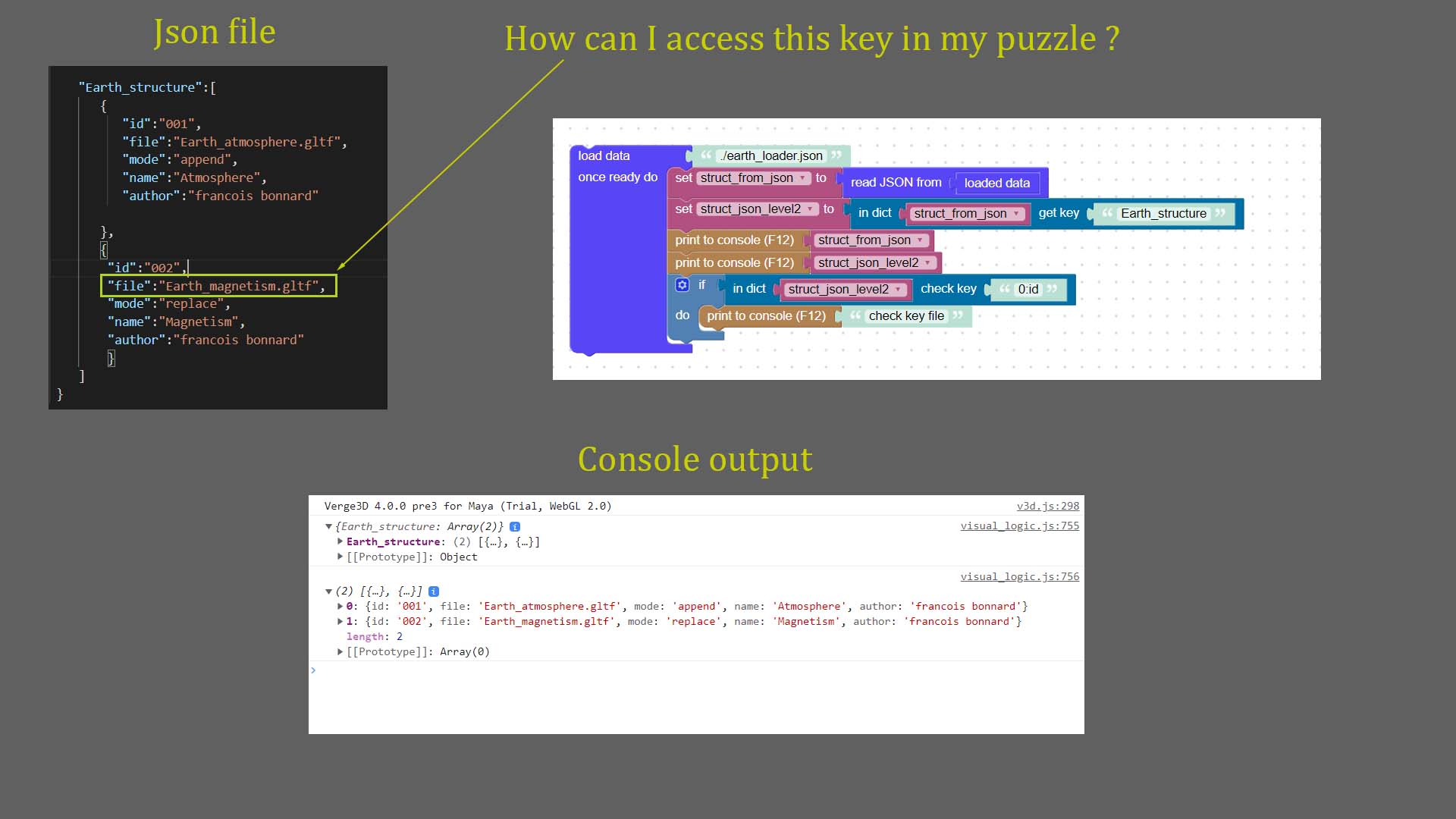

    Hello
    I couldn’t find answers on the forum yet.
    How can I access a particular key:data with puzzle ?
    0:id or 0:file is not working
    I have made a beautifull picture to describe my problem :)

    Sorry to come back on this one.
    But I can’t figure to get the file parameter for a specific id.
    What would be the right puzzle for this json file (same structure as my precedent pos)
        "Earth_structure":[
              "id":"001",
              "file":"Earth_atmosphere.gltf",
              "mode":"append",
              "name":"Atmosphere",
              "author":"francois bonnard"
            "id":"002",
            "file":"Earth_magnetism.gltf",
            "mode":"replace",
            "name":"Magnetism",

    hi,
    Sorry for late response. You have an Array under the key “Earth_structure”.
    So first, you should get this array with dict_get_key. Then, you can get items from this Array (or List) with this puzzle.

    moiamy
    Thanks Yuri. I have found a workaround with csv, but I will try that also.
