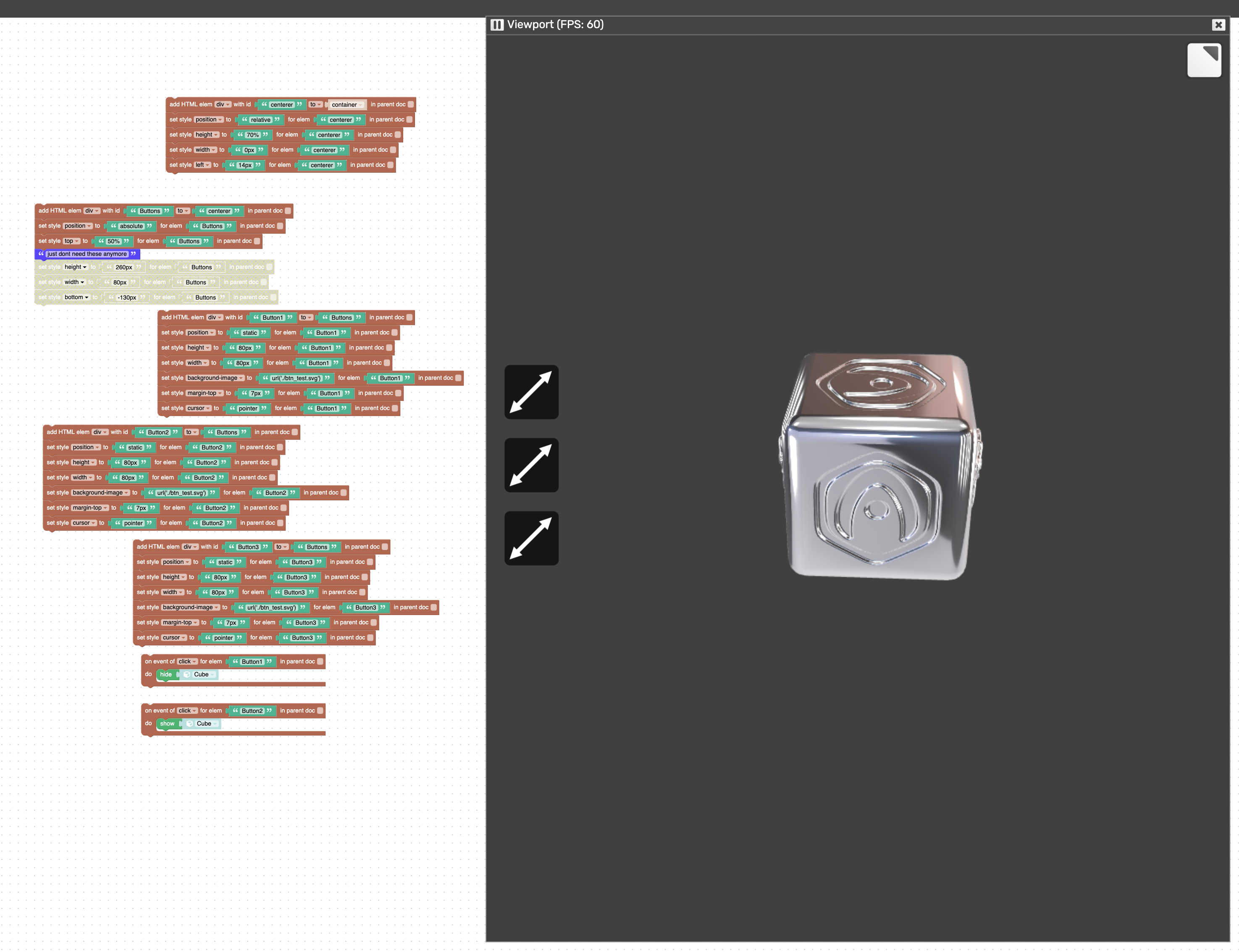

    #46101
    vision
    yes, tested it in running mode.
    this is the youtube video i have been following:
    As of the time 2:48 its working with 3 seperate buttons.
    But then the boxing the buttons together in elementer “centerer” and again putting that in “body” is where the issue is, body is not displaying buttons to I set it to container which displays the buttons.
    Also all ajustments in element “centerer” left, right, width, height have no result in moving the element. Also the button action when clicking is not working, it was working before making the item “centerer”.

    I just tried to recreate the content from the youtube video using verge 3.8. Note the video is 2 years old and there have been some updates to Verge3D so I am happy to say for the most part everything works.
    First after reviewing the concept…the idea was to give the viewer an idea that they could use puzzles to create HTML via puzzles and I think the video is successful in that. However, its not the best responsive approach and a new video or tutorial would be a good idea.
    For starters… I had to add relative and absolute position puzzles as indicated to get things to move properly.
    Now that we have CSS ability, it is actually easier to just create a class and have all your CSS that way either in Java Script or using the CSS puzzle. You can use Flexbox in CSS to have precise control.

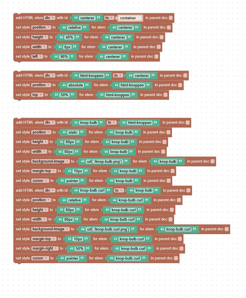

    #46161
    vision
    I just checked Global Illumination example and know understand the css more.
    But for the orientatie setup of the submenu buttons I need some help.
    I now have a row of buttons vertically.
    Now I need each button to have a vertical row of buttons.
    Attached an attempt which is not working yet.
