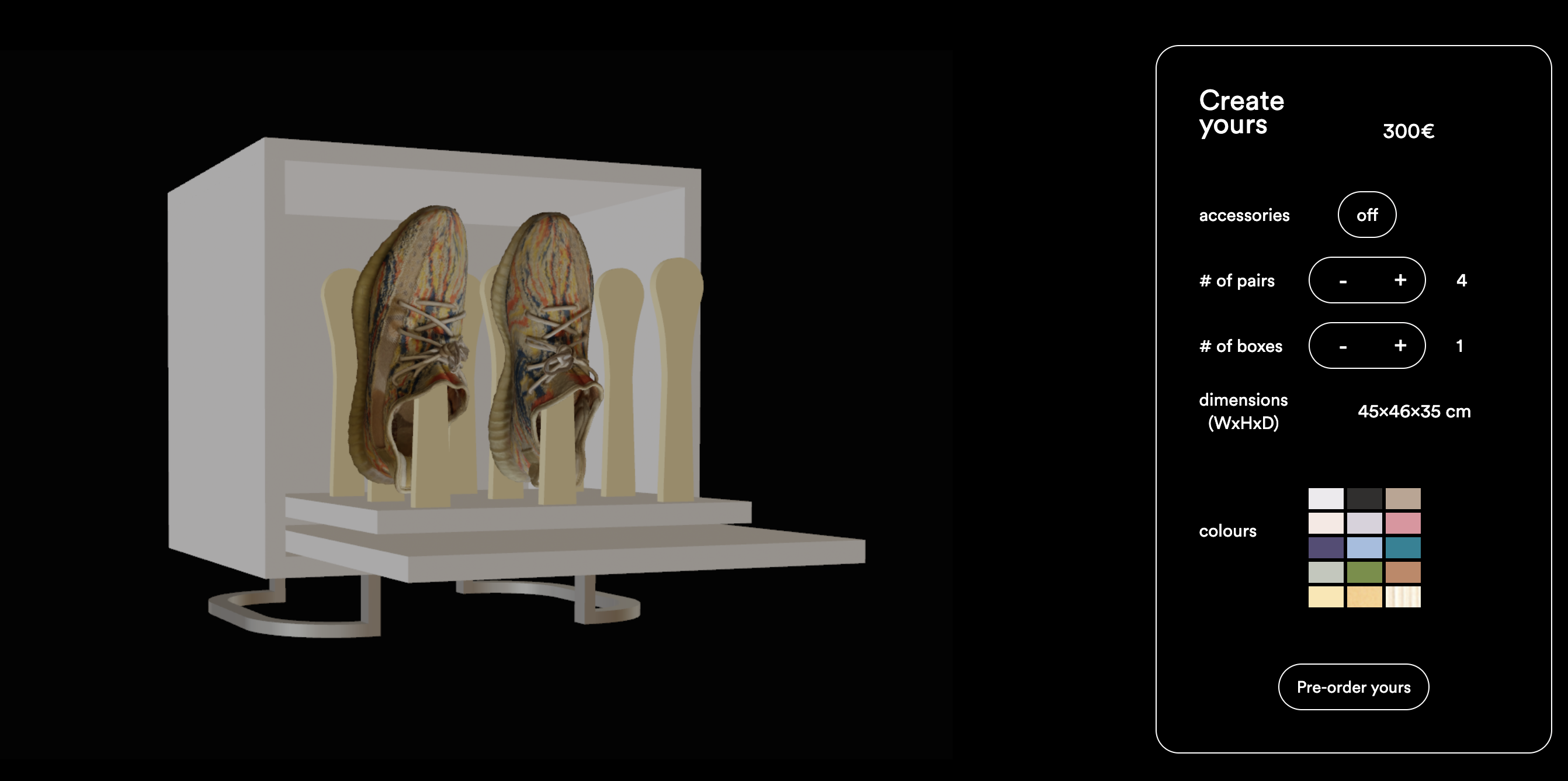

    I am developing a product configurator and before launching it I’ll be doing tests on the maximum number of platforms I can have access. I’m using Verge 3D for Blender 3.91 under MacOS and I had success on MacOS with Chrome, Safari and Firefox. It also performs well under iOS (iPhone and iPad) and Android.

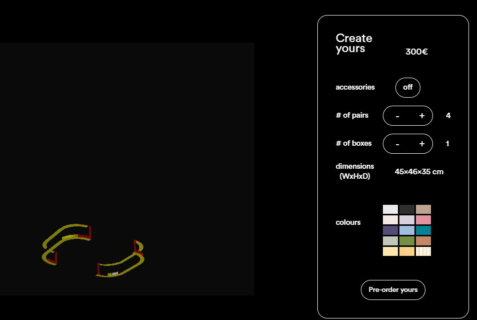

    The problem arises when I use a real Windows machine where the model doesn’t show (only metallic parts appear although not correctly textured). Curiously, when I test the configurator under a real Windows 10 installation through BootCamp everything works well. Attached you can find the correct expected result and the problematic one under real Windows. Could you please help me with this issue?
    Thanks a lot!

    After reducing the files size it loads much faster now! Also, you got a dark-themed website, so you might want to switch to the Dark theme for your Verge3D app as well (requires creating a new app, and transferring all the assets and Puzzles to the app folder).
    As of Windows problem, we tested it out more thoroughly on our own computers and yes, the issue reproduces. Can you share with us your scene file so that we investigate it further?
