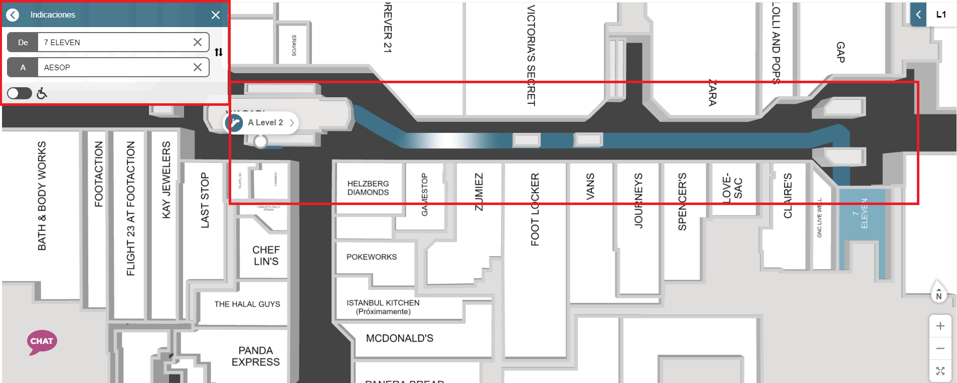

    I am trying to replicate this indicator system from this webgl navegation map
    https://www.tysonscornercenter.com/Map#/
    Does any one has any idea how to acomplish this with 3ds Max and Verge3D?

    #42625
    Walter
    Sorry form not expalining my self well, I was talking about this indications funtion in the map. So a person could view the route from Point A to Point B.
    #42629
    There are a number of ways to do this. Hopefully, you are going to get paid for doing this.
    Given there are three levels and three points of moving up and down in the building and lots of stores there are lots of methods to get from point A to point B.
    There is Pathfinding Plugin …that if it could be modified might be useful and save a lot of work. Otherwise…brut force.
    I would create a table of paths. As an example lets say there are two floors and four stores (A, B, C and D). A & B are on the first floor and C & D are on the second floor.
    Starting with the second Floor…you have to go through the escalator to change floors. So for Store C and D, I would create one animation from each store to the escalator and one from C to D.
    For the first Floor, I would create an animation to the escalator for each store and one for connecting A and B.
    I would then create a look-up table. First Field Is the starting location and the second field is the destination. Knowing these and using the look-up table I know the route and can trigger the necessary animations.
    The more stores, levels and up down points, just adds complexity to the problem but its the same problem.
    You could also substitute the animations for just empty locations endpoints of the animation and dynamically draw something between the points as an option if you didnt want to create that many animated assets.
