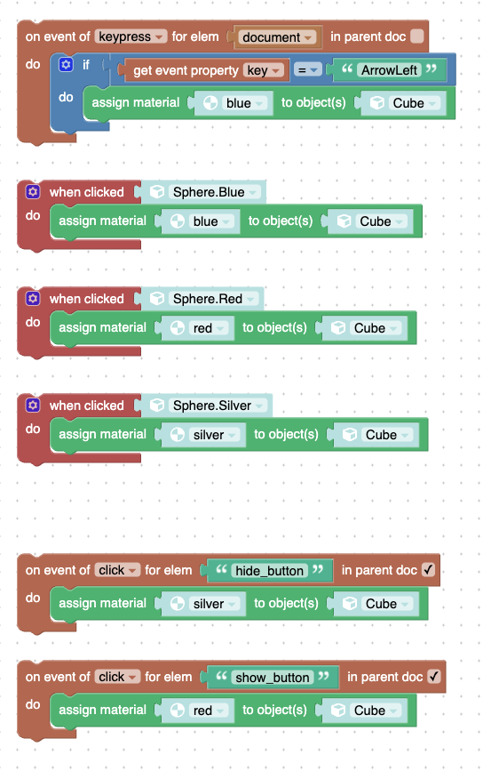

    so I have rebuild a the logic
    everything works but not when I press a button in this case left arrow.
    any idea what is wrong?

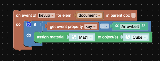

    #66884
    Your puzzles are correct except for one small detail. Replace “keypress” with “keyup”.
    #66887
    Enable in parent doc like in the last two puzzles. When embedded in a frame the app’s page (document) is practically never in focus and doesn’t “hear” key events.
    And yes, you’d better avoid using keypress and keydown. They are recurring events while keyup occurs only once.
