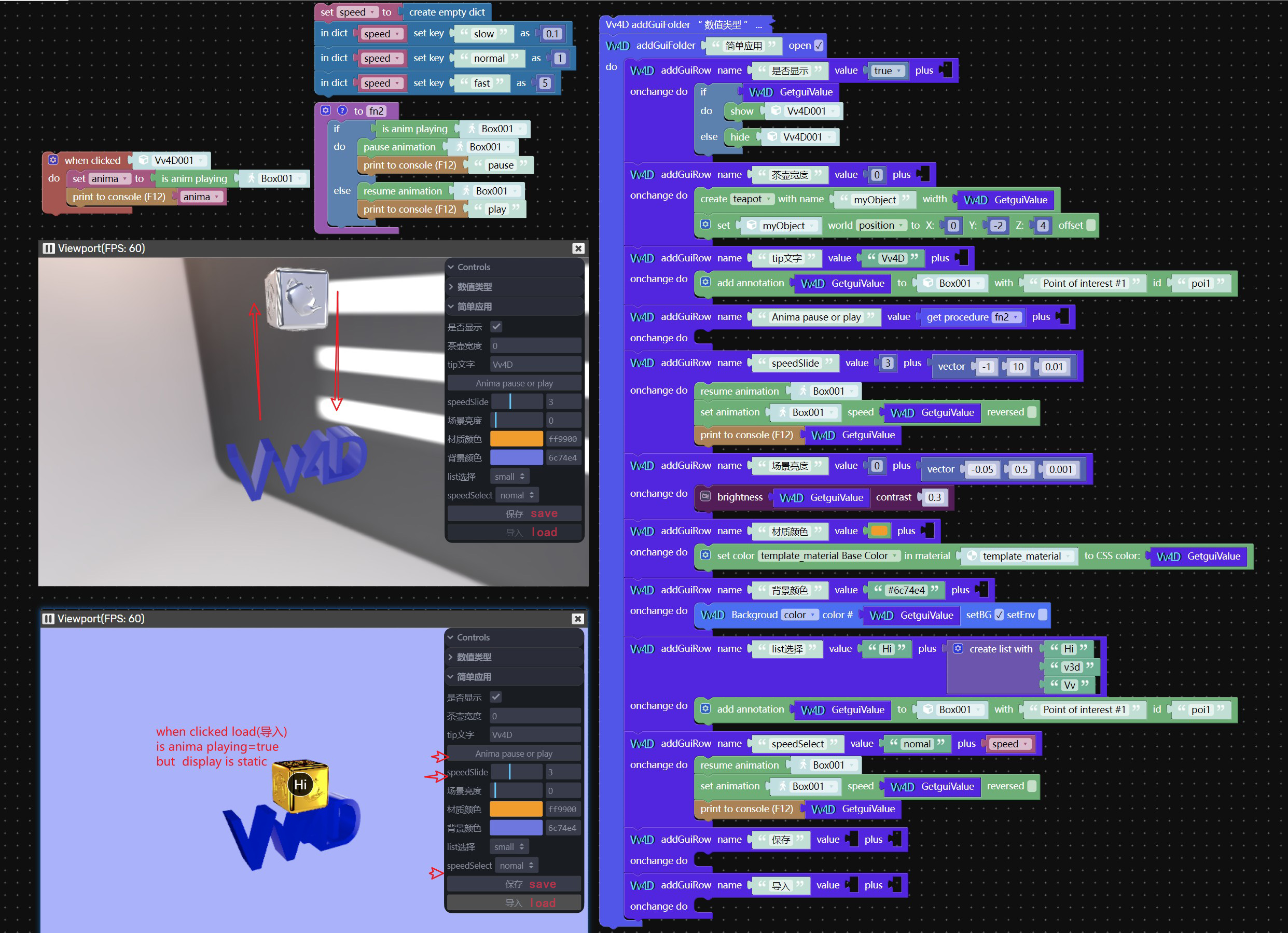

    Hello everyone, I’ve been making good progress in implementing custom functionality for my datgui panel. Everything has been going smoothly until I reached the “load” option. When I click “load,” all the functions work, and there are no errors in the console. However, the objects in the scene that were supposed to have animations are now frozen. Strangely, the console still prints that the “isAnimationPlaying” for these objects is true. What could be causing this issue, and how can I restart the animations?

    “I’ve uploaded a web example to this address https://vv4d.com/datgui/. You can try it by clicking ‘save’ first, and then after clicking ‘load’, the animation becomes static.”

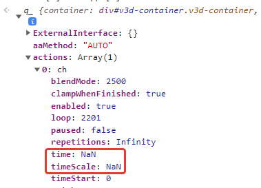

    #67661
    Corrupted action (with undefined speed) after loading
    Most likely the problem is in this parameter
    #67664

    The input text ‘nomal’ from the puzzle doesn’t match the ‘normal’ key, now the issue has been resolved. Thank you very much! kdv :good: “
