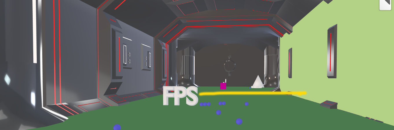

    Hi , can u please explain to me how to do this in 3dsmax & with puzzles? do i have to add another invisible walls to prevent the character from flying out ? i guess there is something wrong here , i cant pass the yellow line in the attached pic .
    I attached the game i’m trying to do (we transfer) ,,,
    I also need help in :
    1-making the monster vanish after being shot.
    2-make a game counter and timer.
    https://we.tl/t-bWosUIvXR0
    PS:the fps camera starts after clicking fps text
