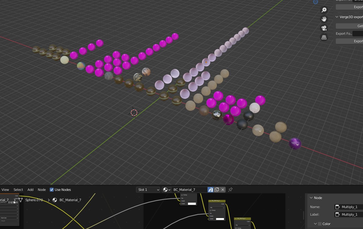

    hi we are trying to make a dynamic material for our configurator , our 3d models have multiple slots of the same material(this are copies in blender spheres image) , currently our approach is declaring the material from blender we are able to change the material programmatically using the same functions that are in the visuallogic file
    but now we want to have a single material of each type instead of copies and dynamically add as many unique clones we need for our models

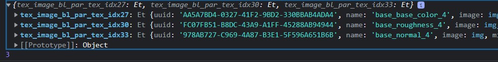

    tex_image_bl_par_tex_idx
    and nodeTextures
    seems to be propietary from verge 3d since is the only result in the web
    here nodeTextures
    it states this
    You can use it to dynamically assign new textures to a material.
    have someone have a solution for this ?

    i cant find any documentation on how to assign the “tex_image_bl_par_tex_idx0” index ,i believe this happens in the exporter
    there is no need to assign new index. Moreover, I suppose it will break the material. Just use clonedMaterial.nodeTextures = {}; and add cloned textures with the same names.
