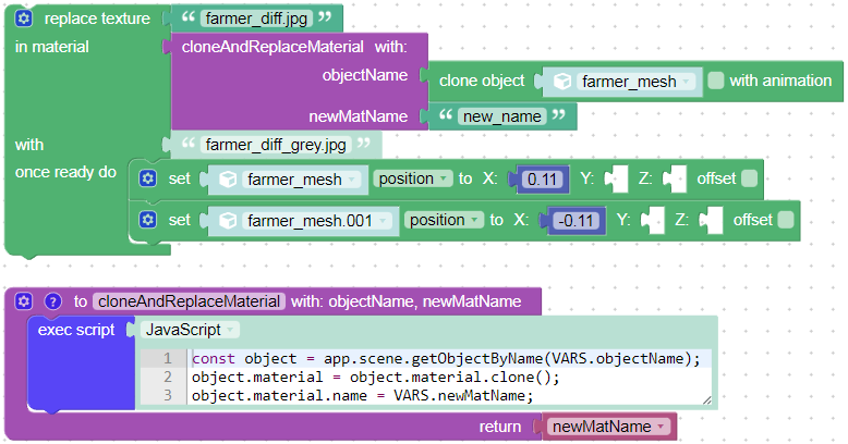

    I’m having some trouble trying to apply custom texture to cloned object.
    you also need to clone the object’s material with a new name. then you can apply any texture to the cloned material.
    #59638
    junglist
    Could you share example how to clone material and not an object?
    #59641
    https://v3d.net/dqv
    But you’ll have to use a new texture image in .ktx2 format. Non-compressed texture image will be replaced in ALL materials using this image.
    For example, you have three material using the same texture white.jpg. If you try to replace white.jpg with black.jpg in the second material you’ll replace textures in all materials. But if you replace white.jpg with black.ktx2 then it will affect only the second material.

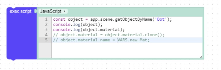

    I have tried your method but for some reason I’m getting an error.
    Mainly because object.material – undefiend
    But if I use getObjectMaterial puzzle it Finds the material.
    Maybe you have clue what is causing this?

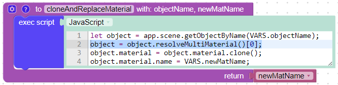

    ‘Bot’ is a Group of meshes (a multi-material mesh). Groups don’t have materials. If the material to clone is on the first place in the list of material then add this string
    object = object.resolveMultiMaterial()[0];
    and replace const object by let object

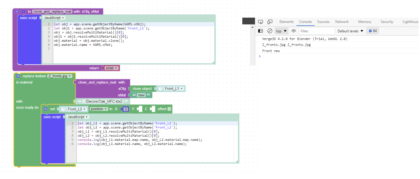

    I have noticed strange thing about *object.material.map.name*
    It shows same name even after texture been changed.
    Maybe that’s exactly why you told to use .ktx2?
    #59713
    I have noticed that this method only works for glTF.2 materials.
    it should works with all materials. but it doesn’t ))) the script only clones a material and gives a new name to it. nothing else. all the rest is done by the standard replaceTexture function.
    the replaceTexture function doesn’t change the texture’s name. It replaces the texture’s image only. The name always remains the same. And this function won’t allow you to replace a non-compressed texture by a non-compressed texture only in one material. It’s possible but it needs the replaceTexture function to be re-worked significantly…
