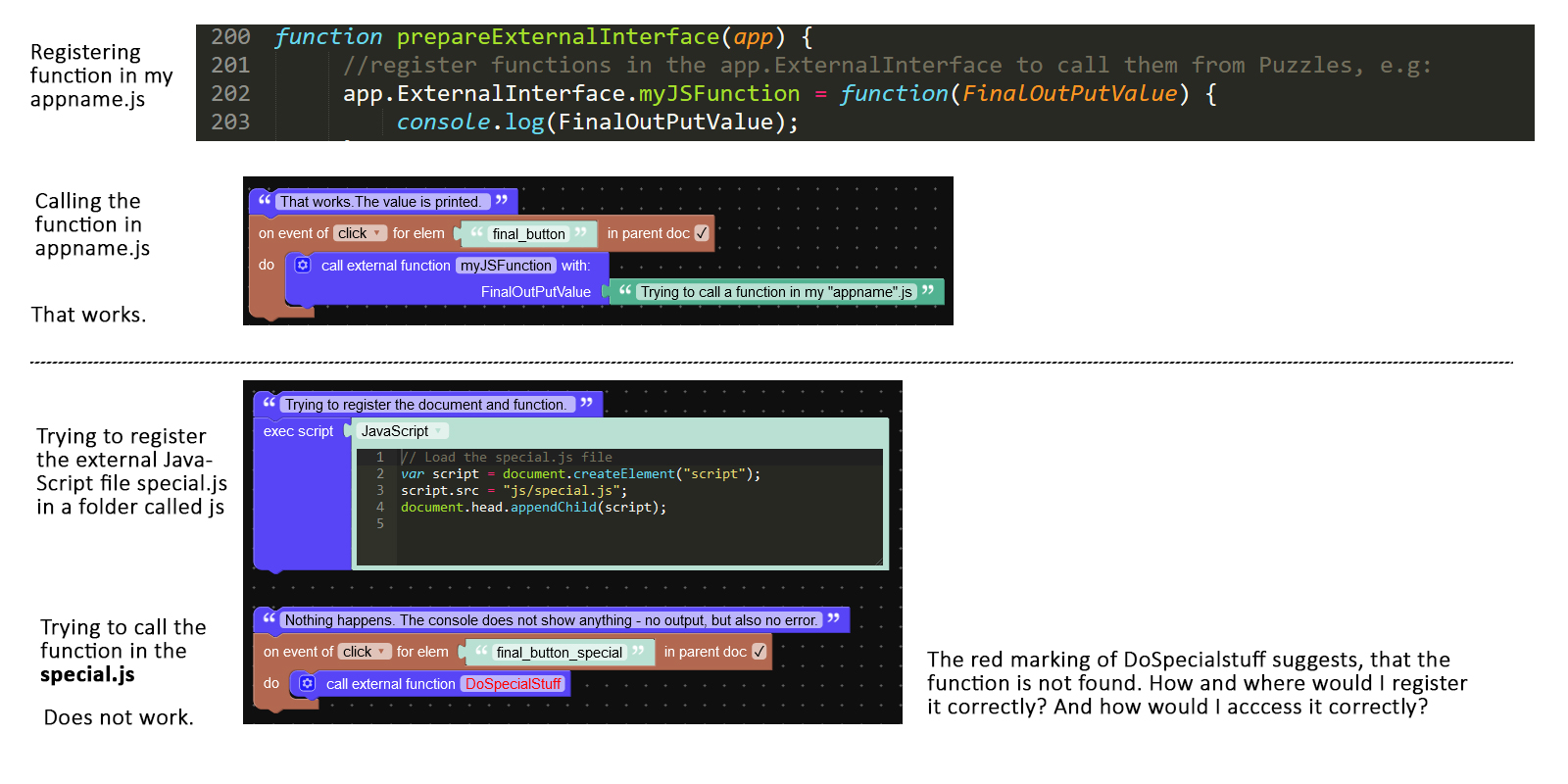

I am quite inexperienced with JavaScript in Verge 3D, but have managed to create a custom JS function in the “appname”.js file and call it when needed with Puzzles. But I am struggling with calling a function from another .js-file.

TimCustomerHi kdv77kdv,
thanks for your quick reply!
I have tried to call it by using the Puzzle “call external function”.
Before I do that I try to register the document in an “exec script”-Puzzle to make it accessible.
I suppose the problem might be just there, because my DoSpecialStuff function is still marked red in Puzzles. As far as I know, this means that the function was not found and therefore can not be accessed.I have prepared an overview of how I set things up and commented it out in the image to keep things tidy. Please find it attached.

Participantthe
exec scriptpuzzles won’t allow you to callDoSpecialStuff()function. It sees nothing outside exceptapp,v3d,VARSandPROCvariables. But you can call this functios from the external functionmyJSFunction. A long way to call )))DoSpecialStuff()is not an external function and cannot be called by thecall eternal functionpuzzle. It’s just a function in another script file.Puzzles and JS coding. Fast and expensive.
