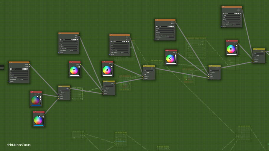

    I am experiencing a strange behavior. My material is simple stacked mix nodes to change color of multiple parts of a t-shirt.
    Everything works fine. Just when i reach to about 10th or 11th mix node in the hierarchy it stops working. Remove one mix node and it start working again.
    Am i doing something wrong? or there is a limit to stacked mix nodes?

    You can use as much mix node as you need, but a mateial can be limited in amount of textures on some devices, so when you remove one mix node the texture no longer connected to the output so it’s not rendered.

    What a bummer. Yes, it is the number of textures. i am short by two only … and i need each to keep the colors separate.

    You can try to disable some postefects (if they exist on the scene) or shadows, to increase amount of textures that you can connect to a material.
