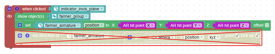

    I want to know how to get the farmer to not turn to the camera in the AR app.
    I want to position the farmer against the wall (and parallel to the wall).
    Only thing is, the farmer is always turning to the camera. So then it is not parallel to the wall.
    I have tried the set position puzzle to xyz coordinates, but no result.
    1. How to get the farmer parallel to the wall?
    2. One other thing, the AR-cross for android use on screen is sometimes getting very small or disappearing. Is there anything to do about that?

    Disable/remove the “set direction” puzzle
    But in this case your farmer will always look in one direction. So you’d better just keep your phone parallel to the wall…

    I removed the set direct puzzle, but indeed the object is only parallel to the wall when you stand parallel to the wall when clicking the cross in android.
    In iOS the object is placed parallel to the wall. But in the iOS part there is no puzzle “set direction” that could be removed. So how does it know?
    There must be a way to make a work-around in the android proces ?

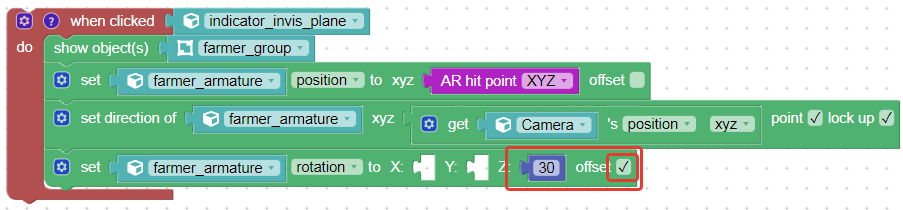

    However it is better to see the chair from a 30 degree angle (more from the side). So I am also trying to figure out how to extract the z rotation from camera and add 30 degrees in the set position puzzle for the object.
    This angle is zero. You just need to rotate the chair by 30 or -30 degrees after the set direction puzzle.

    I used attachment as puzzle setup, so input from get position camera puzzle. And added 30degrees.
    #66781
    How to unsee this? :wacko:
    Actually, I meant a little more simple and effective way
    #66795
    vision
    ok, thxs Did not know what to do with the x and y but apparently they can be left empty.
    #66797
    You could set them to 0.
