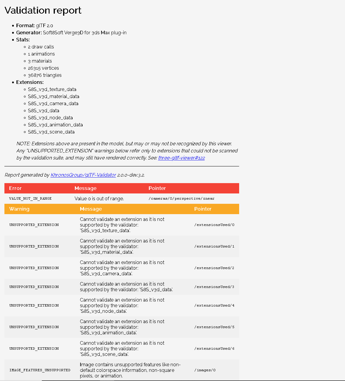

    When you say copied what exactly do you mean? Copied into a Javascript? I’m working with a group of developers that use this https://gltf-viewer.donmccurdy.com/ gltf 2.0 viewer to test the assets. The 3D object is appearing but it is giving me an error on the textures and lighting, etc. I’m attaching an image of the error page for more context. I was under the impression that it would export one file(gltf) that had the textures, animation, camera embedded into one file? Again excuse my ignorance as I’m very new to AR and 3D configurators.
    #33048
    it is possible to load Verge3D’s gltf files into a third-party viewer. However, it is important to enable the gltf-compatible flag for all the materials. Also any other data that are not supported by the glTF standard will likely be ignored by third-party viewers.
    In order for the external assets (textures, mesh data, animations) to be embedded into a single file, you should select .glb rather than .gltf when exporting from 3ds Max.
