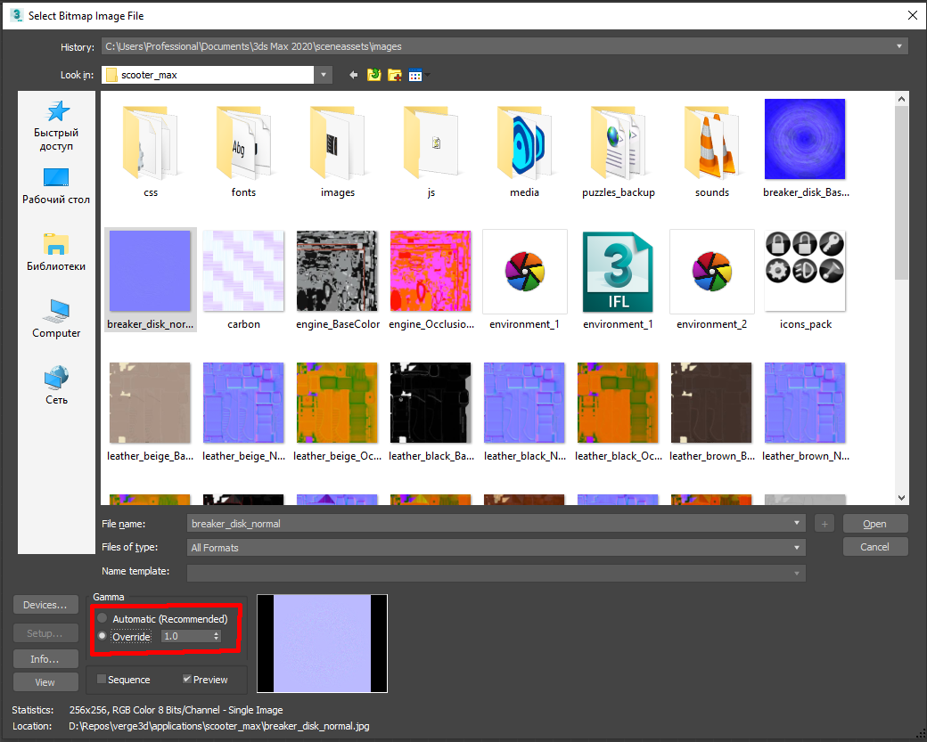

    #27959
    When you open image as maps you neet to choose Override set to 1 as option for Normal Maps, Roughness and metallic maps.

    thanks. yes of course I always use 1 for Normal. I will try also for other maps. Any other specific parameter in verge? gltf2 has to be checked?

    Perfect “ALL” channel to 1 was the right way ( I used only Normal to 1 until now as in my render engines). It seems very close now. The only difference that I feel, is the “specular” look. It seems that Verge boost specularity. So I mixed to 0.5 the black with the AO used for reflection color.I know that this is not “physical” but it’s the only way I found to get close to painter.
