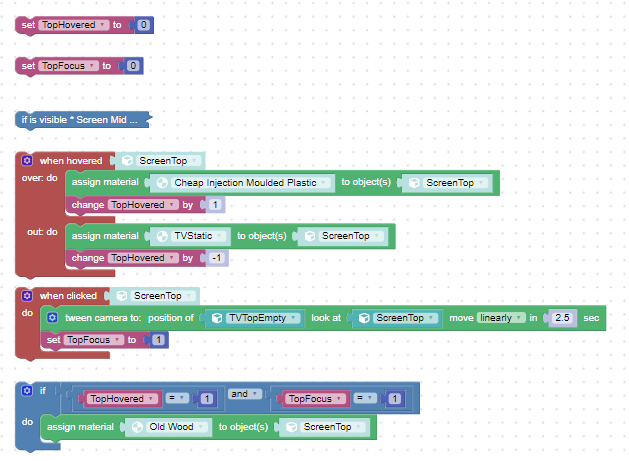

ParticipantHello! I’m fairly new to Verge3D and as such am having a problem with testing for two true/false flags to activate an event. It’s my understanding from the Puzzles that I have constructed that it would work like this;
If ScreenTop is Hovered, change TopHovered to True
If ScreenTop is Clicked, change TopFocus to True
If ScreenTop and ScreenHovered = True, change material of ScreenTop to OldWood
It seems that the way I have the puzzle set up is not achieving that goal. Any help in properly formatting these puzzles would be amazing!
Thank you in advance

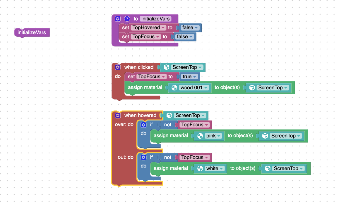

xeonCustomerDid you happen to initialize both TopHovered and TopFocus to false at the beginning of your script, as I don’t see anything thing in the image provided?
Variables are global but need a starting value. So may want to add that to your starting puzzles. If, you already have that. Try switching from True/False to 0 and 1. I find that it works more reliably for some reason.

ParticipantHey Xeon, thanks for your input, unfortunately neither of those approaches seemed to work. I’m sure its error on my part, could you take a look at the second iteration of puzzles I attached?
Edit: After doing a little research I have since moved the items for initilization to the init tab. This did not change anything.

xeonCustomerHi there,
Ok….so correct me if I am making the wrong assumption but I think you are wanting the object ScreenTop to have a roll over state like a website button and then a previously clicked state. Is this correct?
You dont necessarily want to move you initialization of your variable to the Init tab but thats a personal preference.
I typically start my project with a Procedure that is called.
In this case InitializeVaribles.Let me know if this works for you.
Tutorials - https://www.xeons3dlab.com2021-07-09 at 4:24 pm #42710roboticelbow
