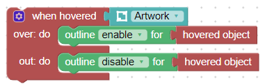

    I have a group of objects. I want all of them to have a feature on hover (enable outline). How do I enable outline on hover for each individual object in the group? Instead of adding this feature one by one?
    However, this highlights every object in the group, rather than just the one that is hovered over.
    How do I specify to target only the 1 object?
    #68920
    https://www.soft8soft.com/docs/manual/en/puzzles/Events.html#hovered_object

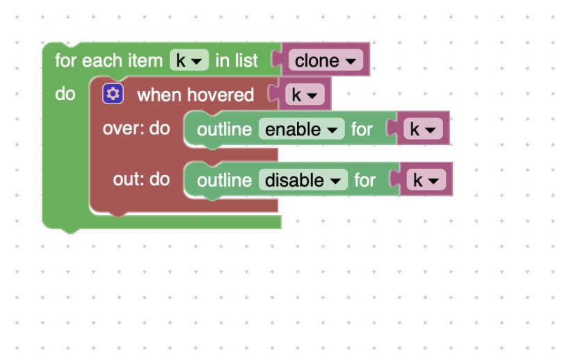

    #68923
    bigmike814
    You need to run it in a loop so they can be looked at individually.
    See the attached example.
    #68926
    This method with a loop is really good to register dragging for several objects at once but is next to senseless with hovering and clicking. It will work but there is an easier way…
    #68927
    ma77hew
    @kdv I tried using the “hovered object” in place of “Artwork” for inside the “on over do: / out do:” section of the puzzle but that did not work. I tried to work with the list idea at first but was not very clear to me how to use it properly. I will give mike’s suggestion a try.
    #68928
    Looks like you did something really wrong if that simple set of puzzles from the official manual doesn’t work for you :scratch:
    https://v3d.net/qmv
    #68939
    ma77hew
    Yes, you are right. I do a lot of my testing from the puzzle editor, which is where I tried this puzzle combo. For some reason this combination did not work for me inside the puzzle editor. Now I understand that sometimes, you need to test your Verge3D HTML scene to see if everything behaves. Thank you
    #68940
    Press the green button Play in the puzzles editor after adding new puzzles.
    Actually, it’s better test your apps in a separate window, not in the puzzles editor’s viewport, for more accurate results.
