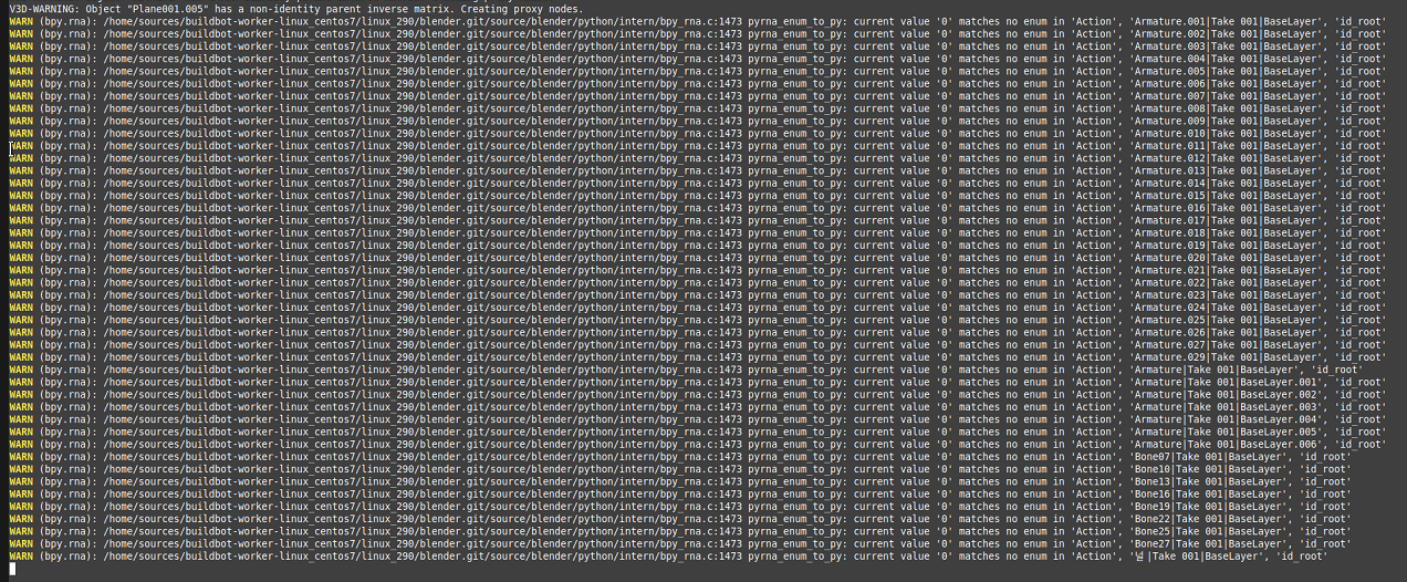

    I am preparing a simple demo. I have a scene that contains approximately 40 fishes models with their armatures.
    Every fish in its Collection and I hide/show these Collections through simple HTML buttons.
    When I uncheck the “Export Animations” checkbox in Verge3D settings tab, it exports GLTF fine without movements. Otherwise, it hangs and waits forever (I tried to wait 8 hours yesterday) with CPU is 90%-100% busy. However, I need to see the fishes moving :)
    I started Blender from terminal to see what is going on and I saw some errors. I believe these errors causing the hanging. I attached the screenshot image. Here is the link for blend file itself:

    I solved it by converting all armature animations to shape keys (via Blender’s ‘Save as Shape Key’ button in modifiers tab). After that I animated those shape keys.
    I understand that shape keys are much more reliable than Armatures in Verge3D (with Blender).
