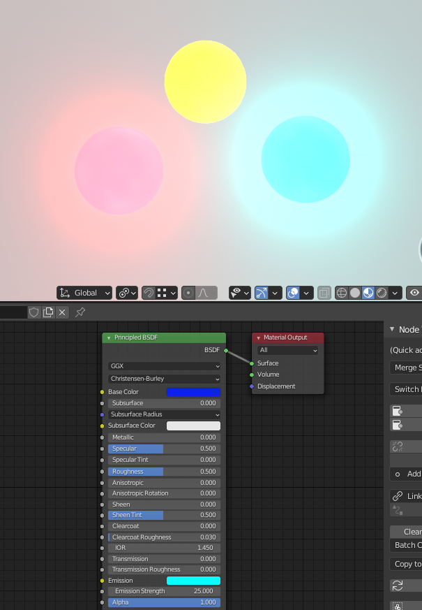

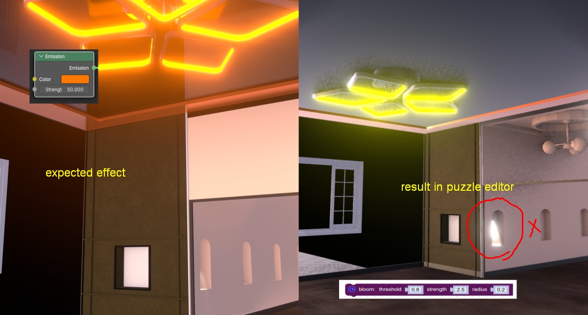

visualizerParticipantXeon correct.
Verge team should do something about this.. I guess.
I have attached a image screenshot of deviation in both applications. Blender and verge.kdv
I saw the thread, But is it 3ds max or Maya or Blender dependent? I tried raising the value to 100 and 2000 from 50. but still other things catch the glow effect unnecessarily.Its really a question of how to achieve this effect ?
Its a simple architectural setup. Every time we can’t expect a space like super black background.
How to get through it?Attachments:

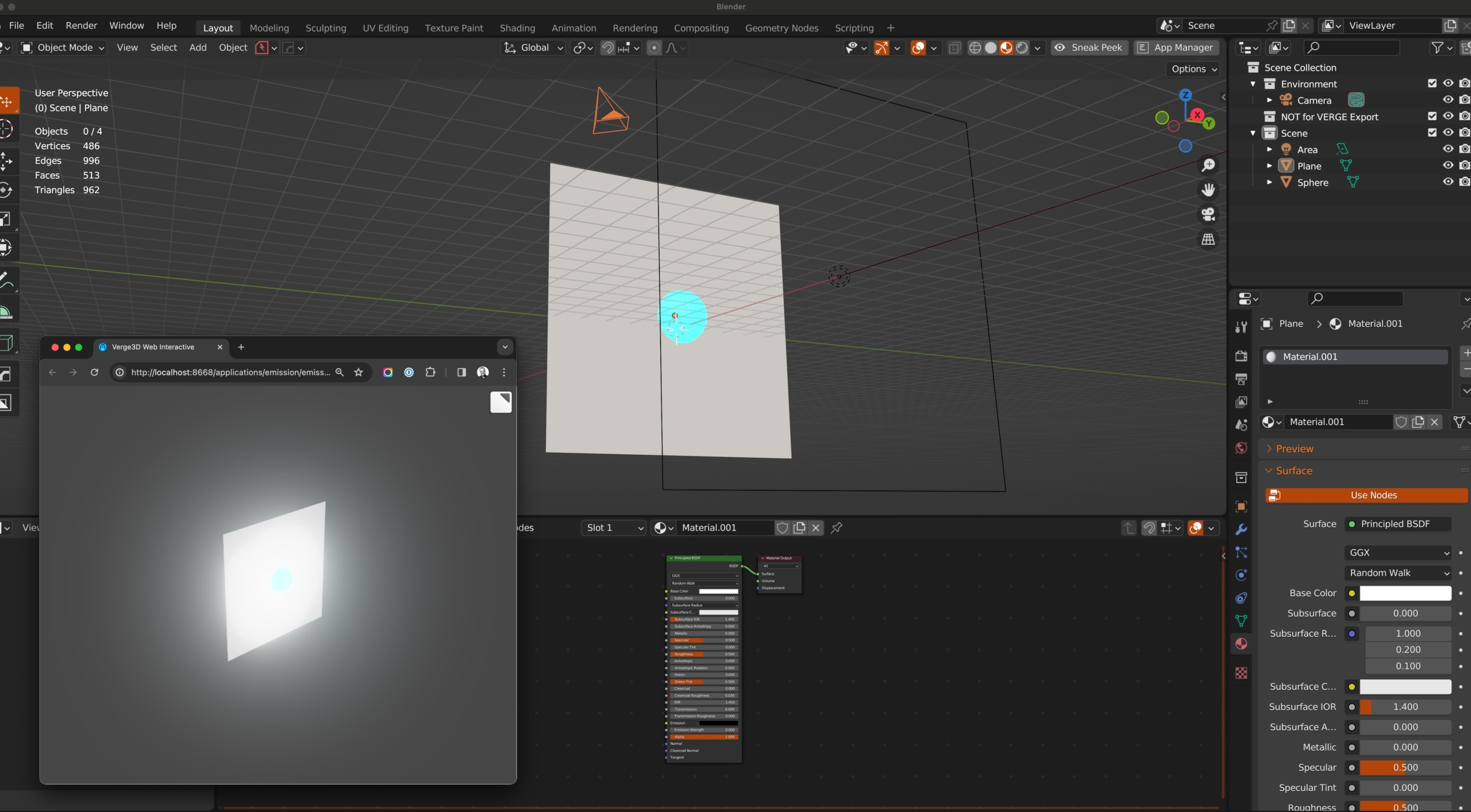

xeonCustomerapply postprocessing effect of bloom to specific material in scene not to others
The answer is no. If you use a post process effect all materials period.
With that said you can minimize the effect by controlling your lighting, controlling the emissive properties of other materials, use very rough and flat materials, minimize reflections, etc.As an example…take a the material KDV has provided. Apply it to a sphere. Create a plane with pure white (255, 255, 255) with emission of 0, (black). Place an area light in front of the sphere perpendicular to the plane. Be sure to scale the area light to be as larger or larger than the plane. You should have a plane with a small sphere in the middle. Use the V3D bloom puzzle KDV shows. Make sure HDR is on and you end up with both the white plane and the blue sphere glowing.
Now this is an extreme example but it proves the point…all materials are affected on bloom is turned on. If you have brand colors and a company that is going to be picky about their specific RGB values…. bloom is pretty much useless as it can cause color to shift colors as even when they don’t look like they are affected by bloom (ie. dont have a glow). Not to mention the color shift get worse based on camera angle.
Now some artists and companies don’t care, requre or their project will allow a bit of creativity, in which case you can tune your scene to your liking.
But the original question was and may be I was mistaken…can you control it to be only one material and the answer is no. You can only minimize the effects it has on those materials.
Tutorials - https://www.xeons3dlab.com2023-12-26 at 1:46 pm #69368kdv
ParticipantThe plane in your example is not glowing. Look at the corneres. All the glowing you see is produced by the sphere and this effect is increased by the area light. But the pure white plane is just lit without any bloom effect produced by its material.

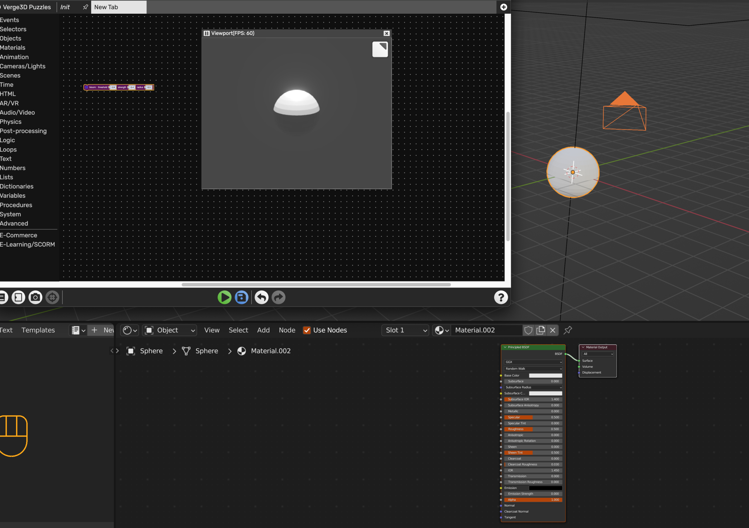

2023-12-26 at 4:59 pm #69371
xeonCustomerHere is a different example. A single sphere. Default BSDF with emmision set to 0 and emission color set to black. Using the same bloom puzzle settings. 5000W area light.
An object that has all its emission turned off…still glows.

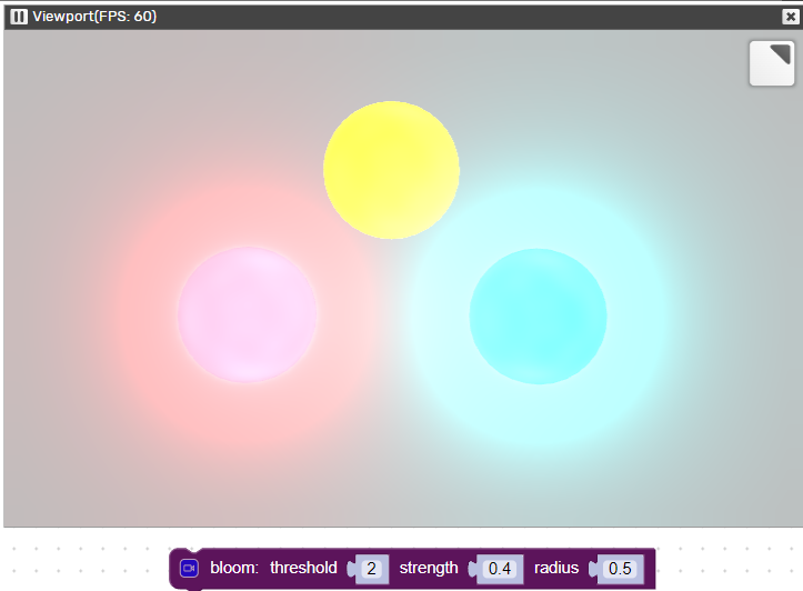

Tutorials - https://www.xeons3dlab.com2023-12-26 at 6:16 pm #69373kdv
Participantyou didn’t get the point?
the threshold should be more than 1 (2+ or even 10 in some cases) to filter really bright spots or materials with a very strong emission. the bloom pass searches for bright spots in the scene and the threshold defines what is bright enough and what is not.5000W area light.
And what did you expect? No glowing with such a bright light on the white surface? The amount of light reflected or emitted matter for the bloom effect. Not only emissiom matters, the light in general matters. The bloom pass won’t work with no lighting at all. HDR rendering matters because RGB values are not clamped to 1. The red color can be represented as rgb(100, 0, 0) and for the bloom pass it will be much brighter than the pure white color rgb(1, 1, 1).
See this demo https://v3d.net/ggb. It’s working exactly as expected.
2023-12-26 at 7:41 pm #69374
xeonCustomerThe point is… all colors /materials are affected. Bloom is a post process effect that affects bright pixels. And process all pixels to some degree. The point is you can not control bloom to one material or object… it’s pixel brightness based. You can minimize it, you can probably get it to work ok for creative non brand work but it affects all materials with or without emission and light and other factors affect bloom.
If you can get it to do what you need great but the answer to the initial question is still no

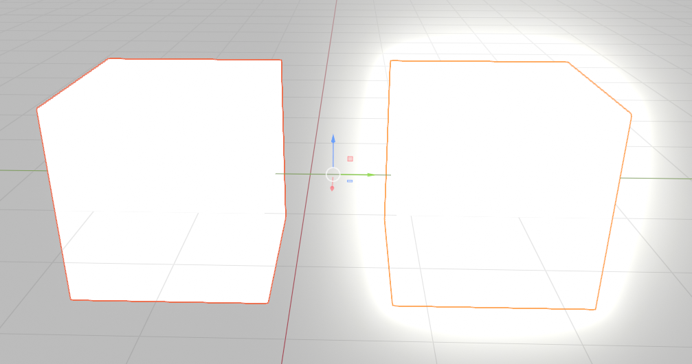

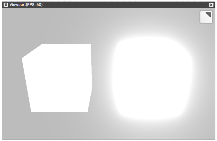

Tutorials - https://www.xeons3dlab.com2023-12-26 at 8:24 pm #69375kdv
Participantall colors /materials are affected.
No.
Yes.
See the source code for the Bloom Pass. It filters bright areas. The brightness is defined by the threshold.
Two different materials. Both are pure white.
