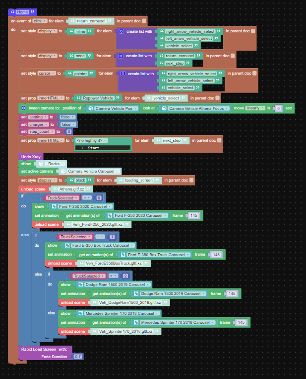

    Hey there! So i have 4 different files of similar objects in a menu to select, all of them use the same naming. I load on file per time, and so there isn’t any conflict in that regard.
    I have a set of certain actions that I want to, for example when a new gltf is loaded, am playing a small camera movement.
    These sets of actions only work for the first gltf in the list, even if I load the other 3 files first, before the gltfNo1. Also 2 objects wont go hidden for some reason, named 2nd set wheel

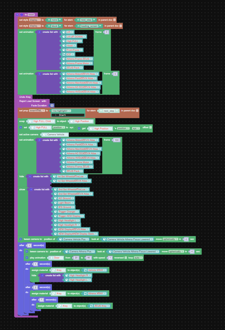

    Here is the function reset:
    #64869
    Do you mean the red action names that are performed only for the first .gltf? Can you share the link to this app?
    #64870
    Jeff Boone
    stuff that are inside the reset function arent applied in all vehicles
    #64872
    Jeff Boone
    Actually everything above the rapid load screen are applied, everything that is below doesn’t work on 3 of the 4 vehicles

    You objects have the same names. Their animations have the same names. When you delete objects you don’t delete their animations (this question is to v3d team. it’s a bug). The point is that you have access to names only (objects, animations, materials) and if you have two or more objects with the same name you can reach only the first one. Objects MUST have unique names.
