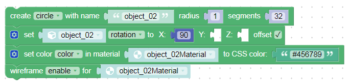

I would like to apply different basic wireframe materials (only the color would change) to copies of a base object (a simple circle), that are create on the fly by puzzles, according to a list.
Basically I have{{object_01, #123456}, {object_02, #456789}}
and I would like to create a circle with the name “object_01” and assign a nem wireframe material with the color “#123456”, same for “object_02”, etc…
Can I do this with puzzles, or some javascrip script that would run inside puzzles?
Thanks for the help!David
2023-08-10 at 10:32 am #65927kdv
2023-08-10 at 11:01 am #65929David Duperron
CustomerHi!
Thank you again, that is quite simple indeed… However, ideally I would like to have only the outer circle line (i.e. draw only a circle, not have the center vertex and the radiuses lines…).
I imagine that the “clone object” puzzle will have the cloned object share the same material and I won’t be able to affect a single material per object.
Do you see a way to clone a base circle (without the radiuses) and still be able to control it’s own material?Cheers
David
2023-08-10 at 11:02 am #65930kdv
Participantideally I would like to have only the outer circle line

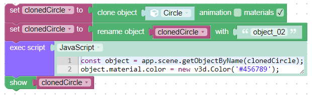

2023-08-10 at 2:00 pm #65960David Duperron
CustomerI can’t make your puzzles work! :(
first I don’t have your “rename object” puzzle, and I always get an error message
Uncaught ReferenceError: clonedObject is not defined
Here is my Puzzle configuration for a very simple scene where I have a Circle exported with line rendering option as you mention.
I’m lost… again…2023-08-10 at 2:10 pm #65961David Duperron
Customercorrection:
I HAVE this puzzle, as I bought your plugin package and it’s included in it… So now the puzzles work and the object is copied, BUT, the material is cloned and both circles now have the same color (the one which is defined in the exec script puzzle)…
2023-08-10 at 2:12 pm #65962David Duperron
CustomerCorrection #2
I also have your “clone object” that I was not using, and which solves this issue! No precise idea of what is done differently, but well… it’s working!
