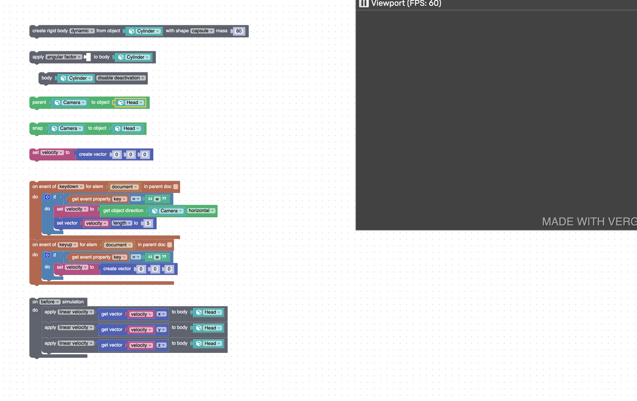

    ma77hew
    I’ve tried to use this tutorial here but I can’t get it working. Here’s my setup. Some of the puzzles used in the tutorial are different from what I see is available. What am I doing wrong?
    As for the Snowball VR, I have taken a look at that as well but it’s a very big setup and I cannot figure out which parts control the camera.
