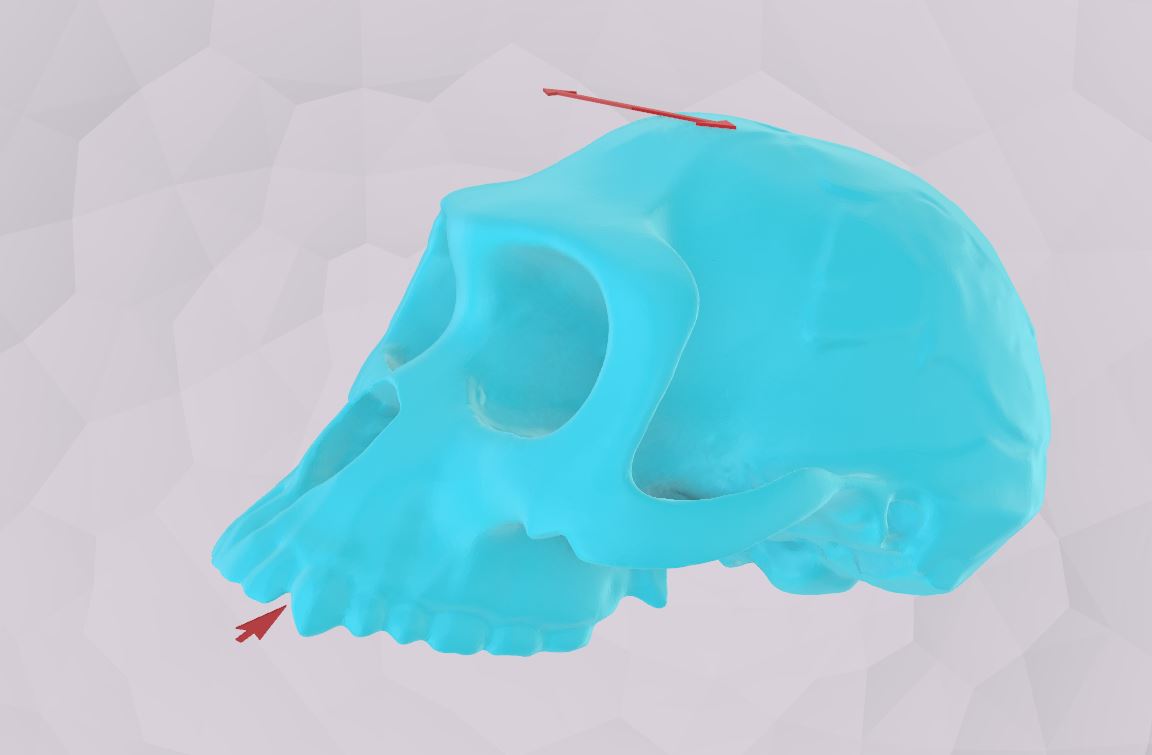

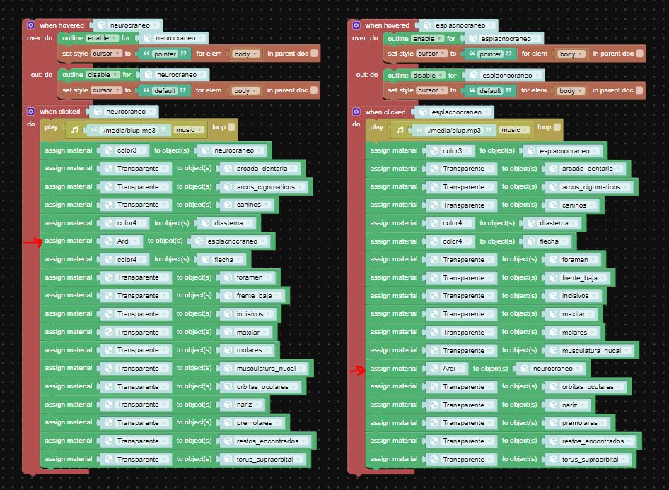

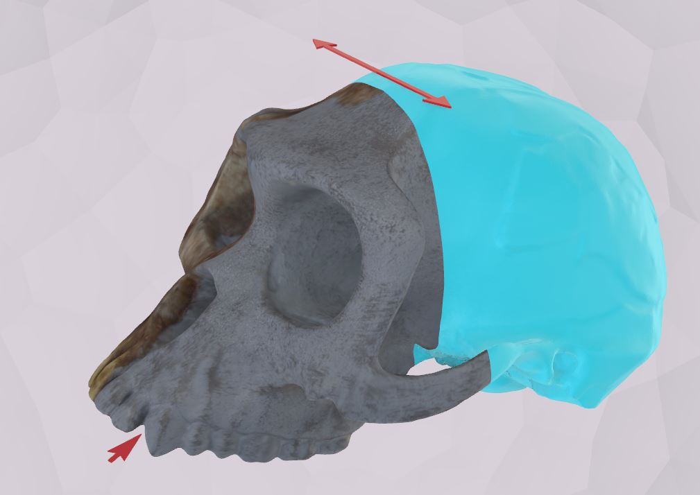

    We have developed an interactive resource. It is a skull that is composed of different parts that, when you click on them, it changes color. It is configured so that when you click on an element, the color of the previous one is deactivated. This configuration works perfectly except in one condition since both parts are activated. I attach an image with the configuration.
    Does anyone know what could be happening? I use verge 3D with Blender.
    P.S. On some occasions it has worked correctly.
    Thanks.
    Xeon’s 3D Lab – QuickTip Tutorial – Assigning Materials
    The most likely reason: the grey material gets lost for further use after assigning the blue material to both parts.
    #66801
    Indeed, I did not have the material in the scene. Thank you very much, problem solved! :good:

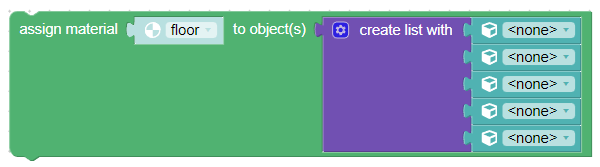

    Try to avoid using puzzles like here
    This way is preferred and works faster
