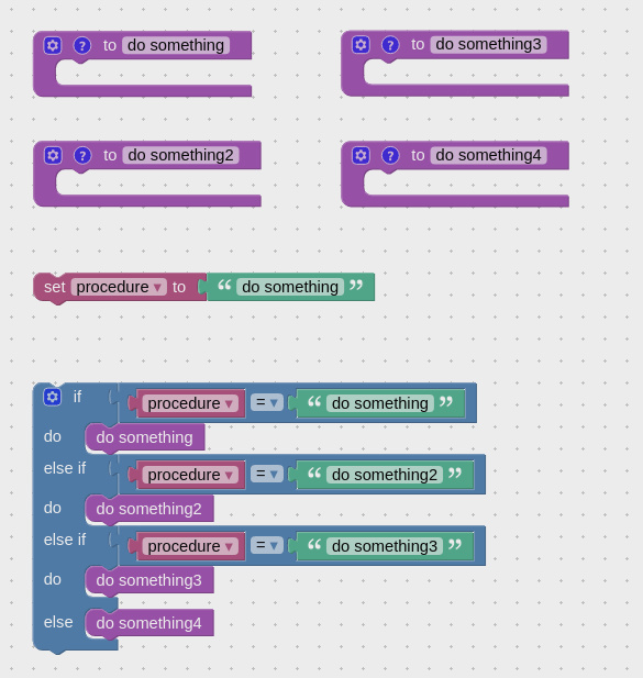

2019-09-21 at 12:55 am #19085GLiFTeKCustomerHi,
Something like this is possible now with logic puzzles. Is it what you’re looking for?
would this be used in a Time “every frame do” puzzle or a Loops “repeat while” puzzle so that the if then is “waiting” for the “procedure” variable to change to something acceptable?
plz share Discord link & on your signature!2019-09-21 at 8:30 am #19086Yuri KovelenovStaffwould this be used in a Time “every frame do” puzzle or a Loops “repeat while” puzzle so that the if then is “waiting” for the “procedure” variable to change to something acceptable?
Yes, you can possibly use that if-else structure inside every frame puzzle, because it is asynchronous. However, this would likely produce an infinite loop with repeat while, which is not.
