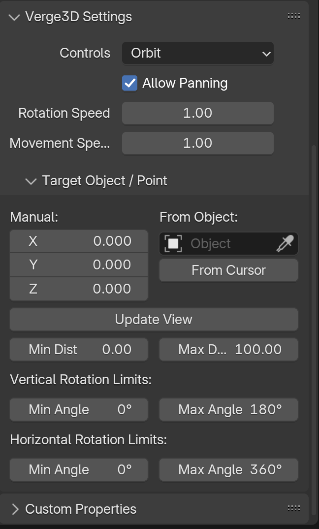

    My settings are attached
    Also, last year, it wasn’t an issue for kdv to assign AWSD keydown puzzles to move objects

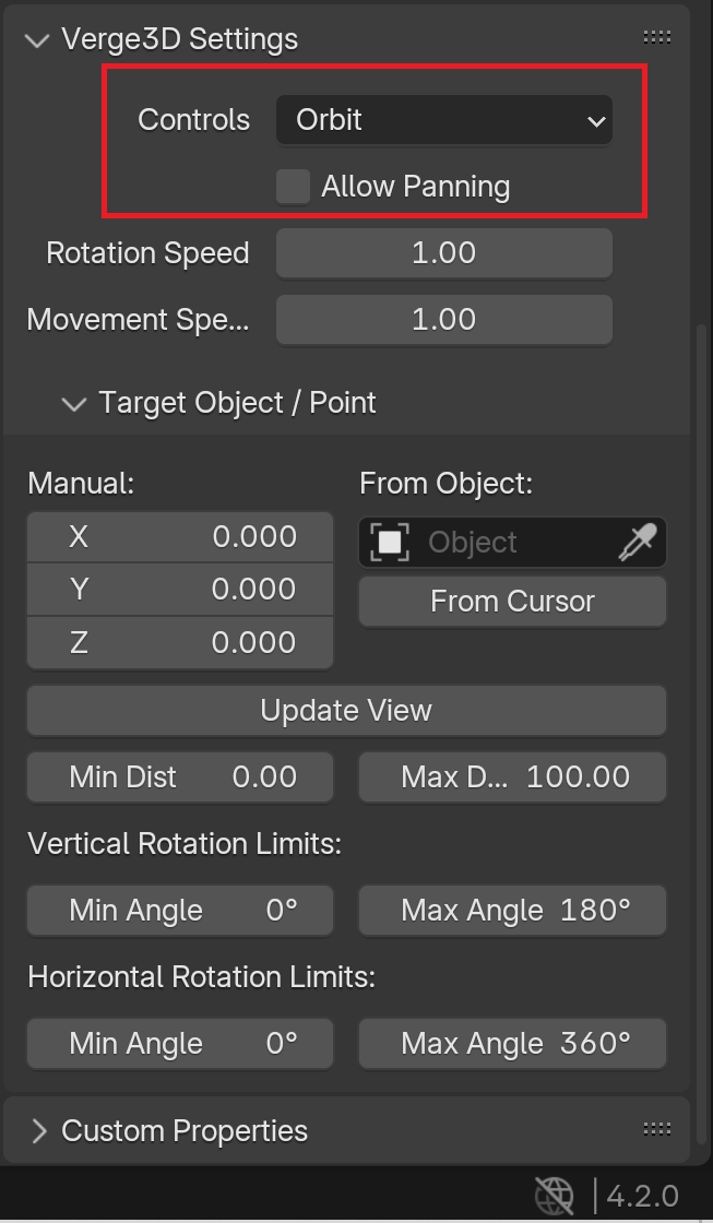

    edit: unchecked “Allow Panning”. Seems like I can move around my armature via AWSD keys. Thanks for your answer, especially for verge3d camera settings
    #76596
    yup…turning off Camera Panning will solve the problem :-)
