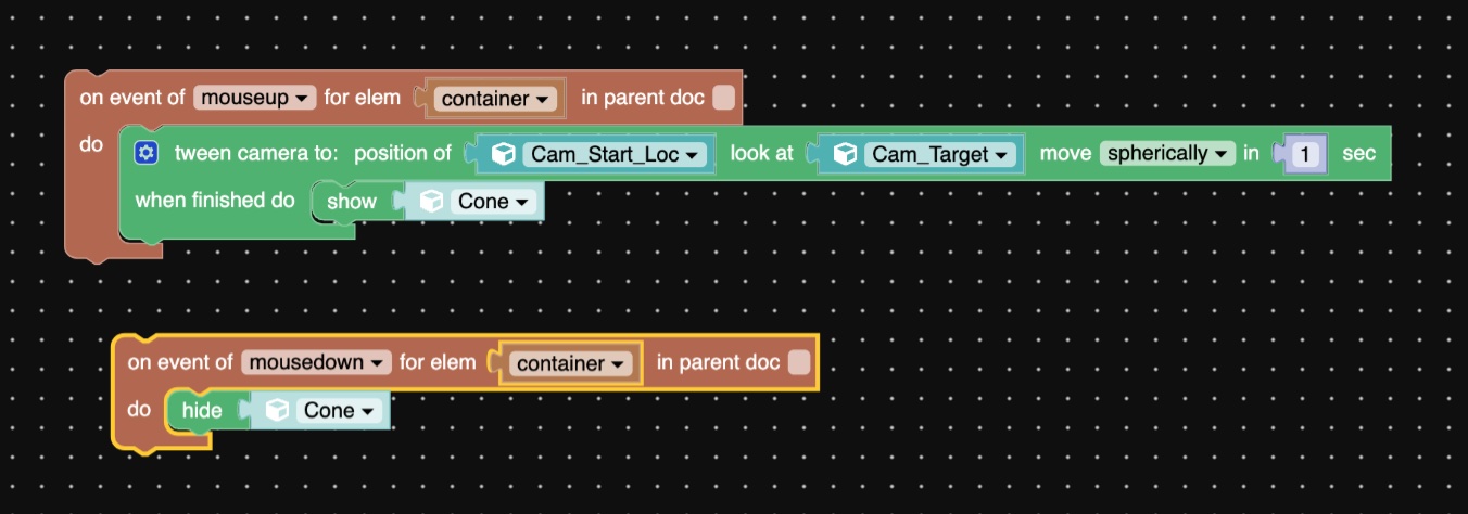

CustomerApparently the drag puzzle over rides blender. I deleted the drag puzzle and it worked fine. Now I just how to figure out how to return the scene to home and hide and show some objects during the movement.
2024-02-17 at 5:45 am #70749
xeonCustomerOk..great.
So you need a mouse down event to trigger hiding of stuff as you rotate and a mouse up event to trigger after the drag that causes the camera to return home?
Tutorials - https://www.xeons3dlab.com2024-02-17 at 5:56 am #70750
There are many ways to do what you are asking….this is by far the most simple and it may or may not work for you needs. If you have other buttons or interactive objects this is not the way to go.
If you have other objects or hot spots or annotations…you will have to see how this interferes with that and then decide whether you need a different type of solution however, the basic principals are the same.
You should also determine whether pointerdown is better for your purposes than mousedown.
You can also monitor the cameras vectors and use a frame timer to test the condition if the camera vector has changed and when it stops…when changed…hide stuff…when stopped tween back and unhide.
Tutorials - https://www.xeons3dlab.com2024-02-17 at 8:17 pm #70760vergecurious
