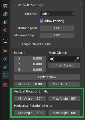

    Its exceedingly rare I would suggest rotating a scene vs rotating the camera. Its easier to implement and its much more efficient and user friendly.
    The camera you want to use is an orbit camera which you are doing now.
    You can set the speed at which it rotates in the your Camera Properties Verge3D settings..there will be a rotation speed control value you can set.
    There are also vertical and horizontal rotation min and max limits you can set in the same panel.
    The only thing that you will have to write some puzzles for is the return to home after the mouse is let up after drag is done….but you are not going to use the drag puzzle.

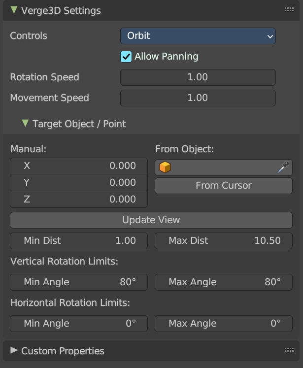

    Thank you for your in depth comments. I now have three cameras. I have one for the drag. One for the zoom and one for the rotation. I’m able to lock a camera vertically but not horizontally. Not sure what is going wrong. No matter the setting I have 360 degrees of rotation.

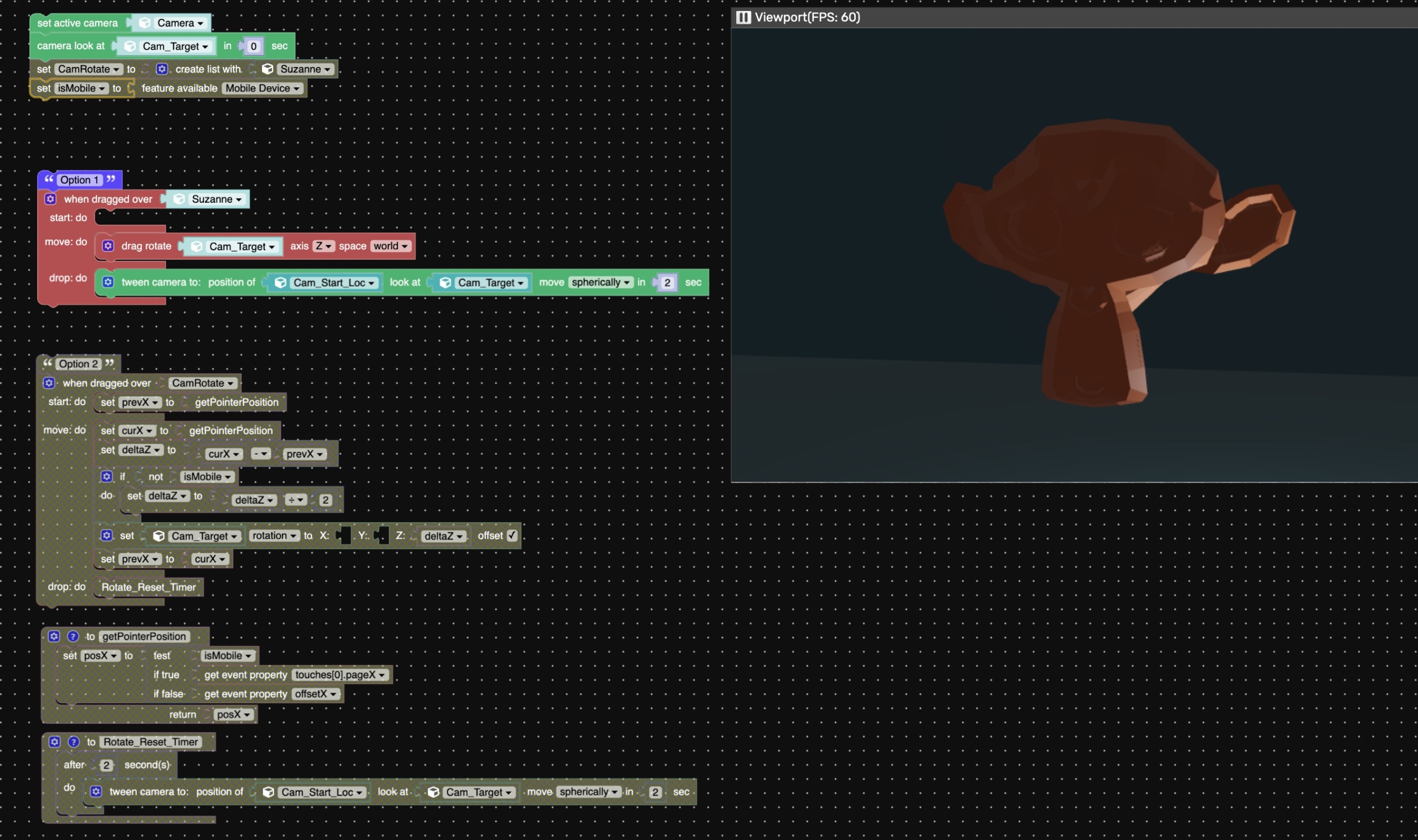

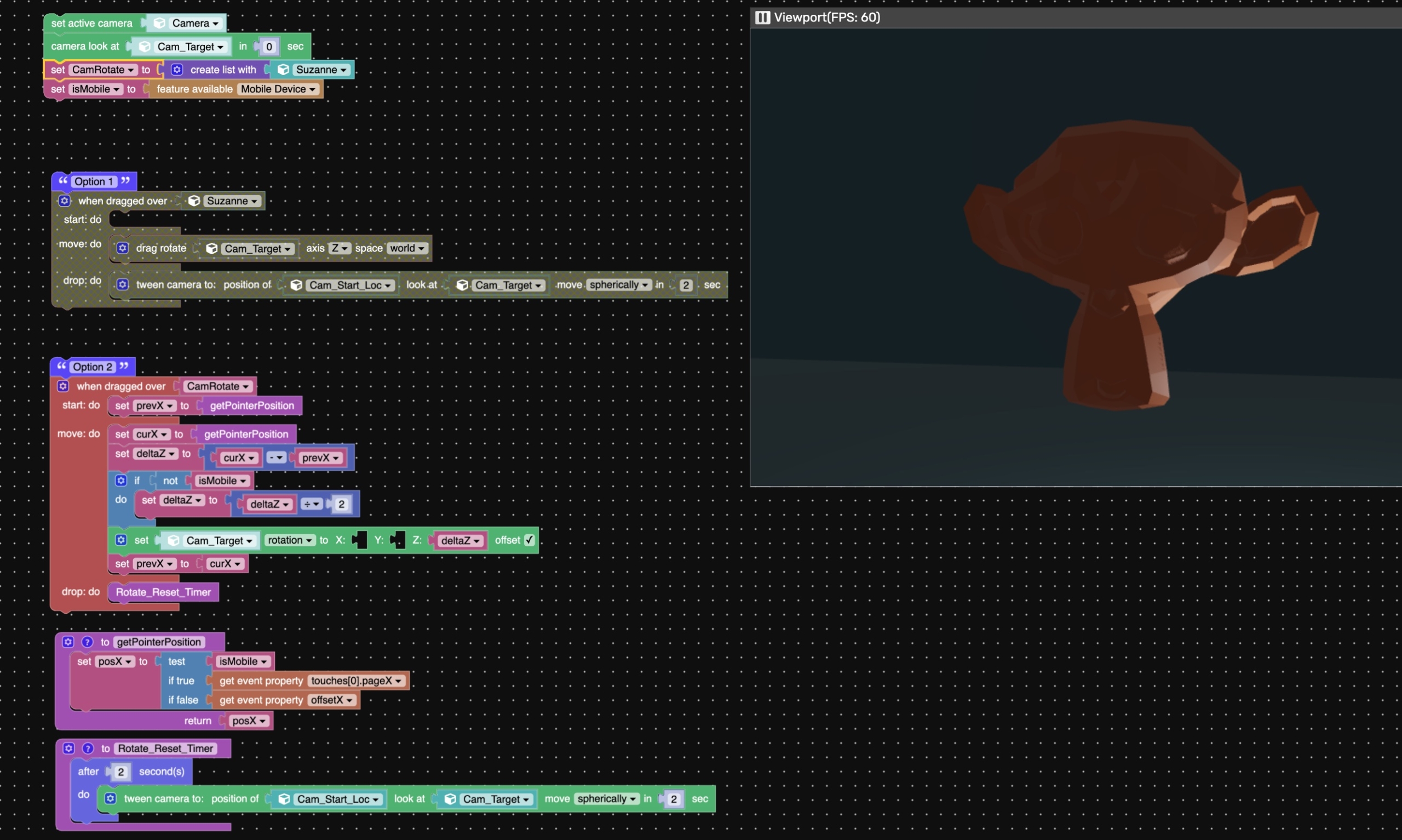

    Here are two options to choose from if you really want to drag rotate the object to make your scene move. The traditional way of doing this is the way KDV has outlined above.
    I personally prefer option 2.
    demo: https://v3d.net/t3v
    Zipfile with blend file:https://v3d.net/t40
    Overview:
    The scene has a large box representing the walls and floor. Box is single sided with normals flipped. I was being lazy.
    In the center of the box is Suzanne. Inside Suzanne is an Empty called Cam_Target. The starting position of the camera has an Empty called Cam_Start_Location. The Camera is parented to the Cam_Target. This allows the rotation of the Cam_Target and the camera will orbit correctly around the Suzzanne and the room.
    Additionally there are Rotation constraints on the Cam_Target they are set to -30 and 30. You can set them up however you want.
    I provided two puzzle options. Option 1 is super simple and Option 2 provides you more control.
    You can learn more about them here: https://www.youtube.com/watch?v=Fvz1CZleReE

    0 and 0 will not work. it’s the same as 0 and 360 :unsure: use -xx and +xx.

    Working my way up I started with option 1. But the “drag rotate” puzzle does not give me a world option, only local and parent.
    #70743
    be sure you are using verge3D 4.5 or higher.
    Be sure to use them small blue gear in the drag rotate puzzle and turn on “use space option”
