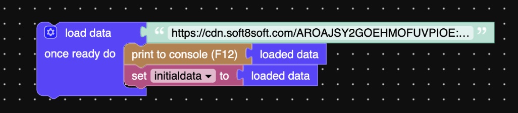

    You can just enter the URL into the load data puzzle and it will work if you have access rights.
    The following is a simple example… I have placed a json file on the soft8soft cdn.
    You can then access this file while playing the app back in the app manager using the load data puzzle by entering the url to the json file. The key is the file has to be accessible.

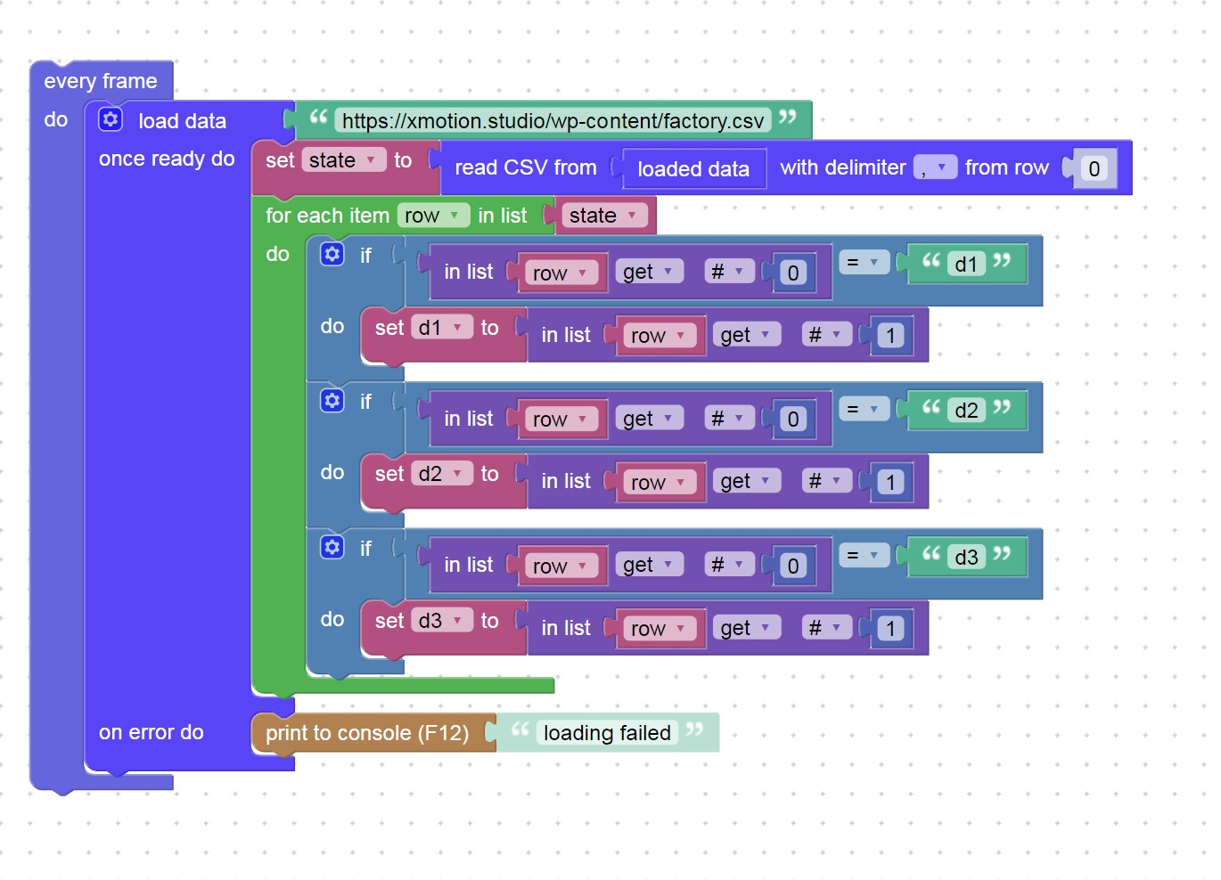

    I’m not sure what am I doing wrong, but I’ve attached a screenshot to my version of the app.
    The URL can be opened on the web browser so I believe it is accessible.
    Here’s the url:
    https://xmotion.studio/wp-content/factory.csv

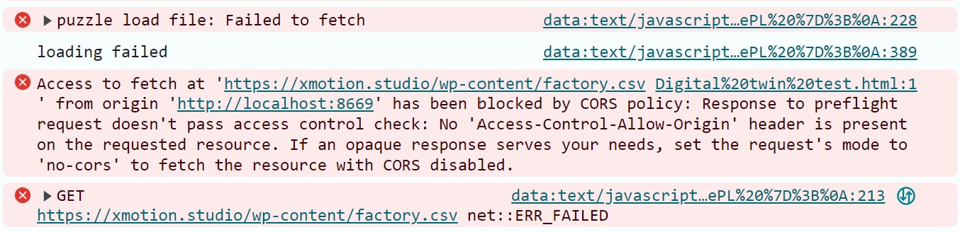

    when I tried to trouble shoot, I found some errors. I’ve attached the screenshot as well.
    I tried to upload it to v3d network and the same error appears! it seems that this csv file has to be on the same server or domain name.
    Update: when I uploaded the files to my website, and the csv file is also uploaded to my website but with another path, it works but it does not update in real time when you overwrite the file. It responds to that change after a minute or a bit less which is ineffective in case of a digital twin.
    I’m happy to hear anyone with a possible solution though.

    Well…your console log tells the story.
    The CORS Policy is prohibiting you from loading the file.

    You will also not want to try and load data every frame. its going to take a bit of time do the handshake with server and download the data. You might want to start with something like every 15 seconds and then reduce if your speeds are capable.
