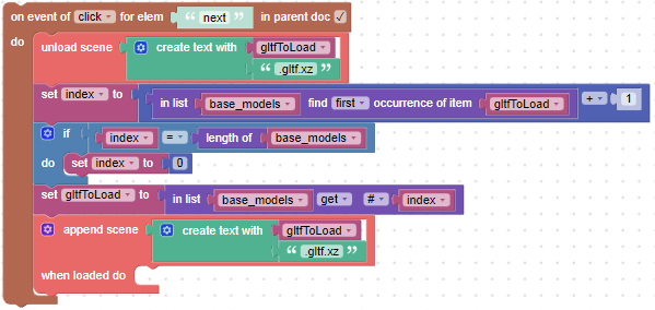

    I have a master scene environment where models are loaded from separate file of each 3d model.
    In puzzle, I have a defined a list of models which loads with click of next/previous buttons. Everytime we click next/previous, first it unloads the current model and then loads next model from a separate .gltf file. Everything is fine until it reaches the last model in the list because I have defined list concurrence puzzle and get # + 1 puzzle to load the next model.
    I have also tried using if/else but it ovelaps when it reaches the last model.
    I have seen some loop puzzles on forum but it’s not working somehow maybe I am doing it wrong. Can anyone design a puzzle and share screenshot of that?
    Thanks in advance!

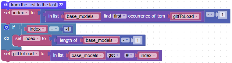

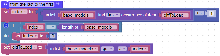

    Need to see your puzzles. There should be two conditions for the last and the first items in the list.

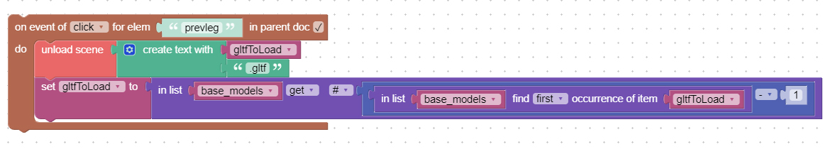

    #55620
    For Next button
    For Prev button
    #55625
    krazy4
    It didn’t work, having same issue
    #55628
    Did something wrong. It must work. These are the elementary conditions for skipping from the last to the first item in a list and vice versa.

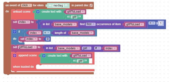

    krazy4
    here’s my puzzle…
    #55634
    The puzzles are correct to skip from the last item to the first one.
    I have the same puzzle set and it skips from 0 to 4 and from 4 to 0
    p.s. use print to console puzzle to control what index is chosen. You can control every step in the browser console to see what’s wrong…
    #55636
    krazy4
    ok it worked, there was some problem in last model.
