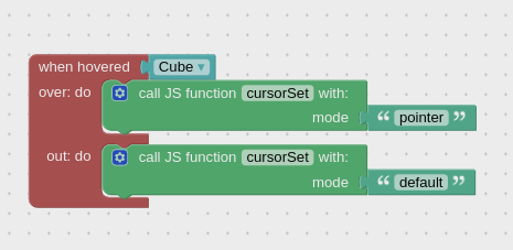

2018-03-19 at 3:43 pm #2996Yuri KovelenovStaffHi,
Sure you can do it with ExternalInterface. Inside your_app.js find the prepareExternalInterface function and register a function with
document.body.style.cursor = mode;
inside it:function prepareExternalInterface(app) { app.ExternalInterface.cursorSet = function(mode) { document.body.style.cursor = mode; } }
Your puzzles can look as shown on the attached image.
