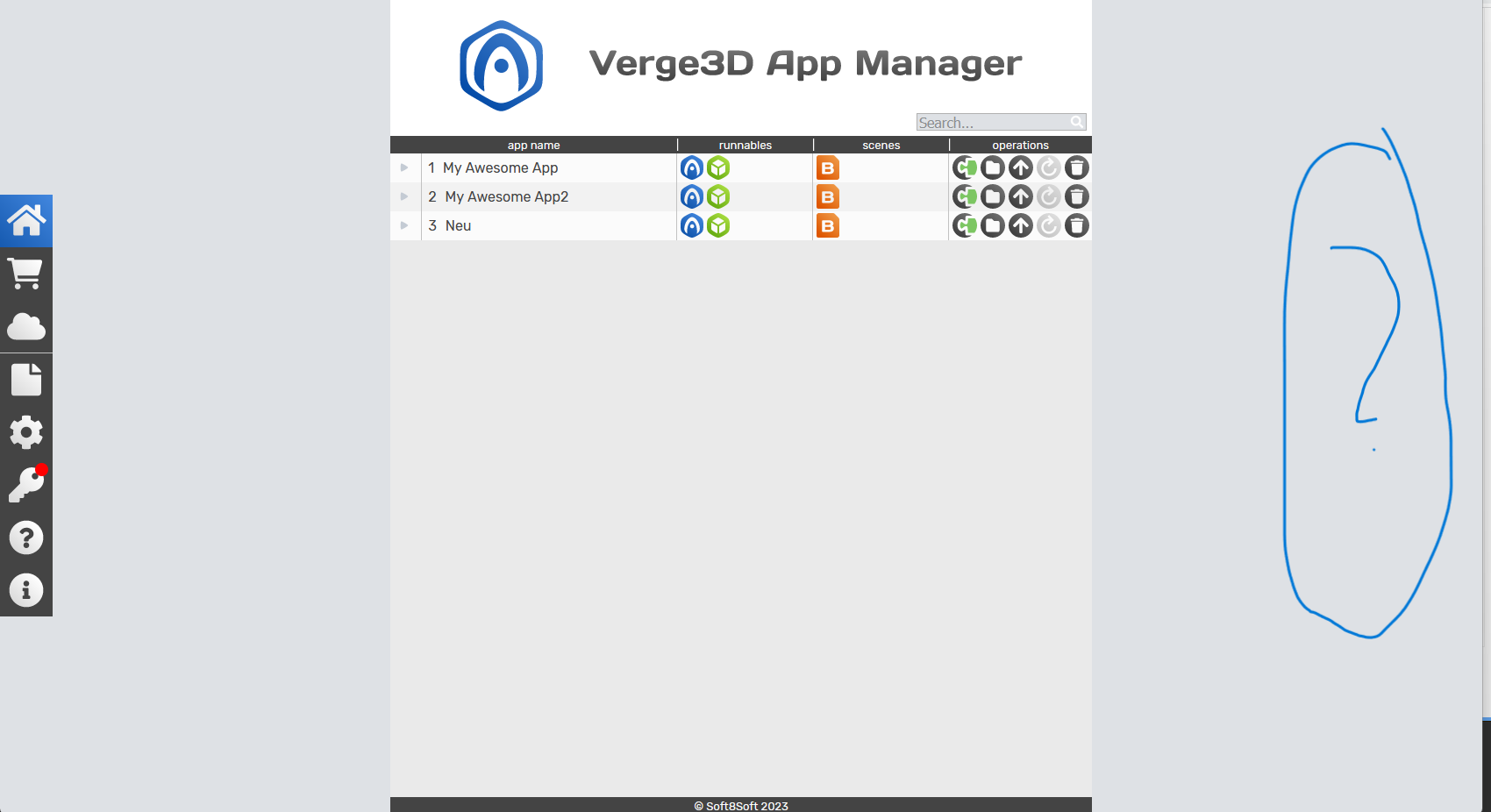

    #65049
    julianm
    Why is there no possibility to convert my app to SCORM package on the right hand side of my App Manager ? will it only be there if I purchase the licensed version ?
    best wishes
    Julian
    #65054
    Click on the app’s name…
