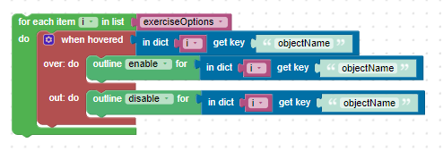

    I think there’s a bug when you put an event inside the loop.
    I would like to create a number of Events based on the number of X. So like if Count = 3 then create 3 when hovered event. I tried the Loop but it only creates 1 event.
    Is this a bug in Loop or in Event? Or is there another way on doing this? The attached file is the puzzle I created.
    #36221
    try to put your when hovered puzzle inside a procedure.
    #36222
    It’s working now. Thank you so much! :good: B-)
