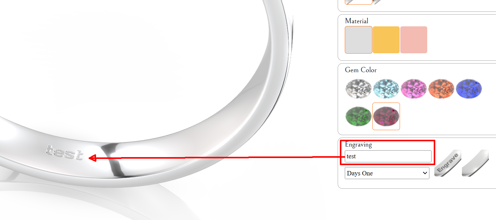

    I saw this in vrege 3d asset itself that the text in html field can be represented in 3D. Can this be reversed?
    No. It’s not FineReader )))

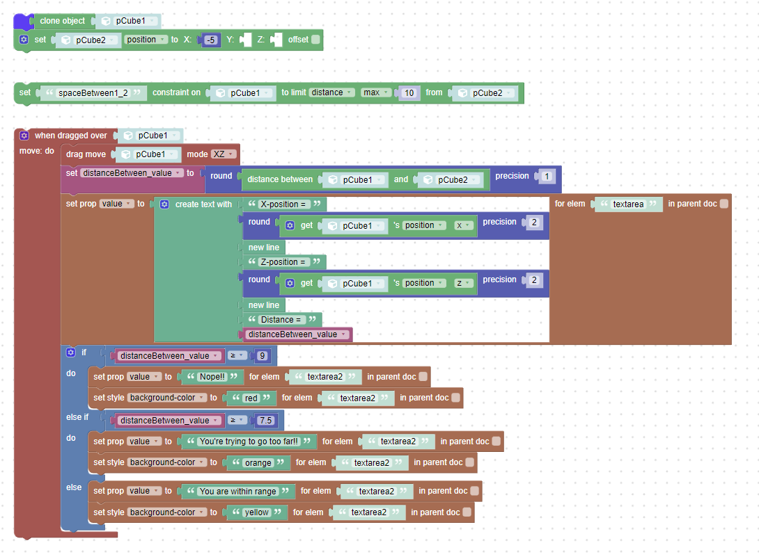

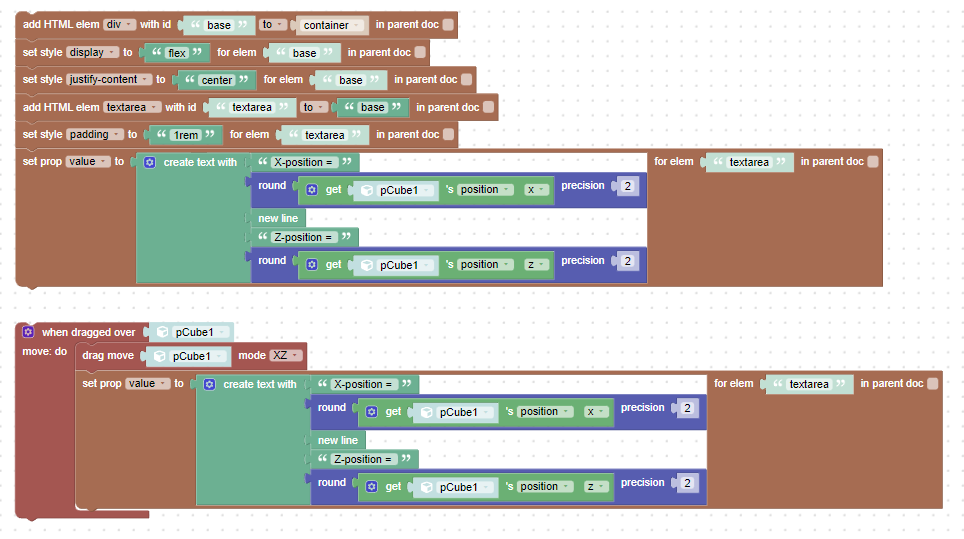

    Yes. By using the set prop puzzle you can send any value or information to an HTML element from the v3d container:
    https://www.soft8soft.com/docs/manual/en/puzzles/HTML.html#set_attribute
    https://v3d.net/f7o

    Practically any information in the scene can be read, saved as text (and then restored like here to re-create the scene) or displayed in some part of the page. The question is what information do you want to read? How and where do you want it to be displayed? And what for? More details…

    Example – The recent elearning demo the cooler fan rotates. So if user drags the cooler fan unit towawrds the edge of platform it should pop up that, Supply wire length is only 2 meter or 3 meter pulling more will unplug it & may damage the wire. if user still drags it then it should unplug wire and stop the fan. ( While this happening; some field shows the distance value beyond allowed number). Is it too much to expect from V3d as of now?

    Yes, that is possible. I am no expert like kdv, but by playing with the puzzlers i’ve done something like what you are describing:
    https://v3d.net/f7o
