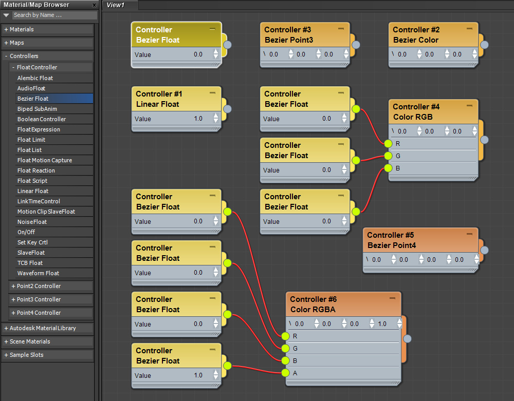

Some slots (e.g. diffuse color of the Physical or Standard material) are accessible even without adding controllers.I’m going with Physical Materials but am really lost trying to understand what’s going on here. If I don’t need controllers for Physical materials, why are they mentioned ?
Please can someone show me an example of how this is done – I’m really having difficulty getting my head around this concept – I’m new to Controllers, Physical Materials, Puzzles, everything !
And that’s before we start talking HTML and Javascript……
For now I am just trying to understand how I can Set Color to an object (the default Box)
1) How do I ADD a controller to the Diffuse (Base Color) of a Physical Material ? I use the Node based Material Editor (3DS Max 2020) and it won’t connect to the Base Color Node ?
So, I’m stuck at this first point !

Yuri KovelenovStaffIf I don’t need controllers for Physical materials, why are they mentioned ?
Because sometimes you need more complex interactions then just modifying colors.
But which Controller would you advise would be best for me to assign ?
Physical material parameters can be animated or changed with Puzzles or with code using Float or Point4 material Controllers.
How do I ‘retrieve’ the RGB components selected by the User ? (this is getting into JS and HTML territory)
First, you need to set up a color picker. Then, you can find (from its docs or by reviewing the code) in what exactly form does it provide colors. You must convert them to RGB values ranged from 0 to 1 before using with puzzles.

Yuri KovelenovStaffNo problem! BTW here is the freshly created Manual page on Controllers:
https://www.soft8soft.com/docs/manual/en/introduction/Materials-Maps-Reference-Max.html#Controllers -
