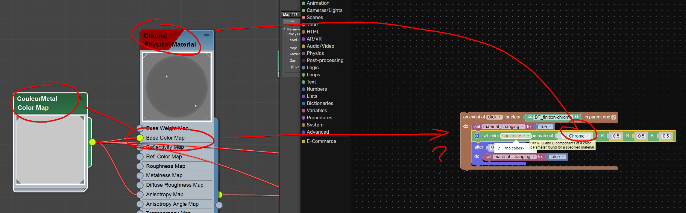

NaxosCGCustomerHello,
the colorMap node in 3dsmax used to work in past projects, now it does not work anymore : whatever color of it, the gltf is black.3dsmax 2021.3, last Verge3D (yesterday).
Tested the shader with a simple bitmap : works.Any idea ?
EDIT : i need it because i’m using a Com^posite node for AO multiply

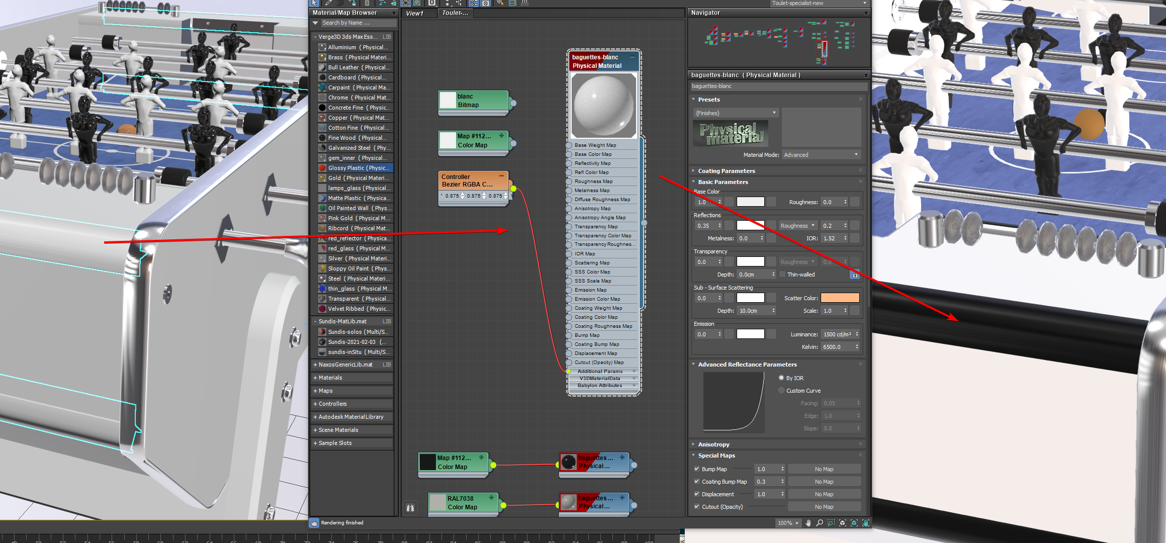

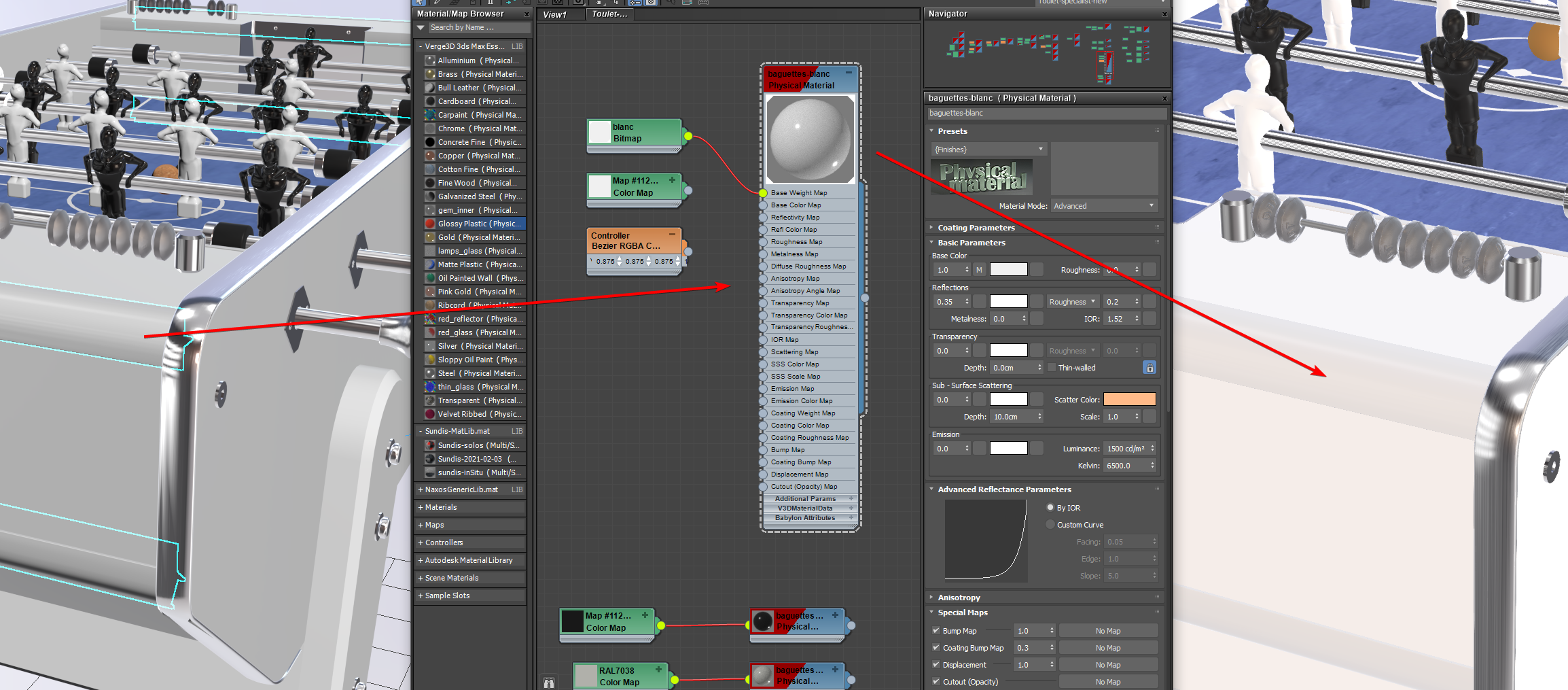

2021-02-18 at 3:15 pm #38698
NaxosCGCustomermmmm. It seams that Bezier RGBA does not work anymore too.
Help !
2021-02-18 at 3:27 pm #38699
NaxosCGCustomerSee, with ColorMap and controller : black, with bitmap (filled-up in white) : white.

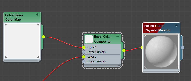

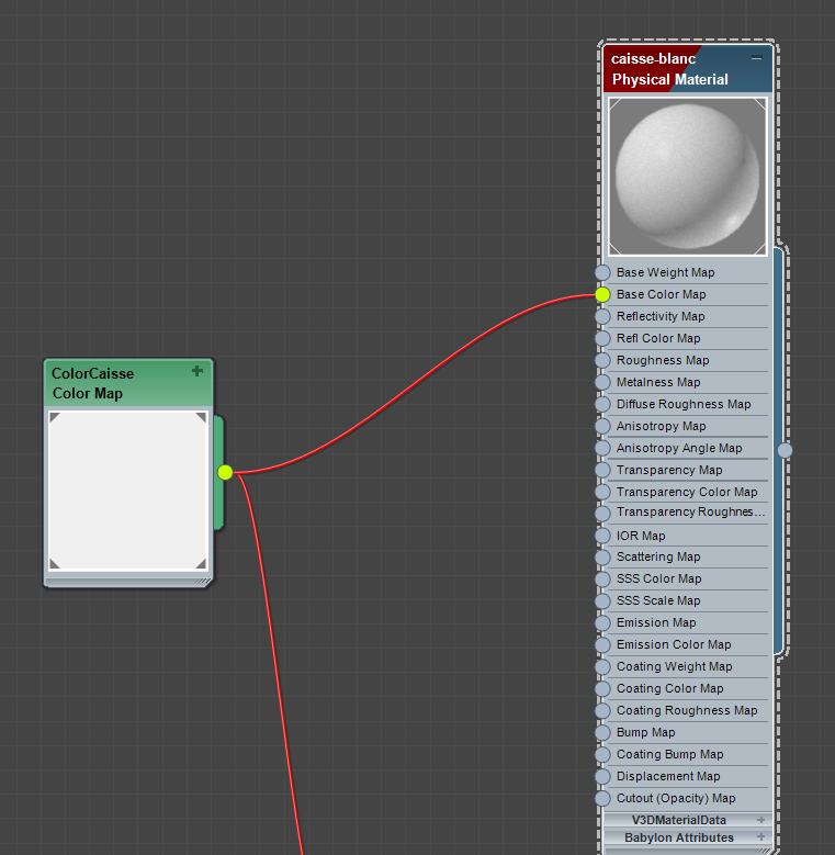

NaxosCGCustomerMy bad: only controllers are back working, not the ColorMap node.
See my screenshot :
