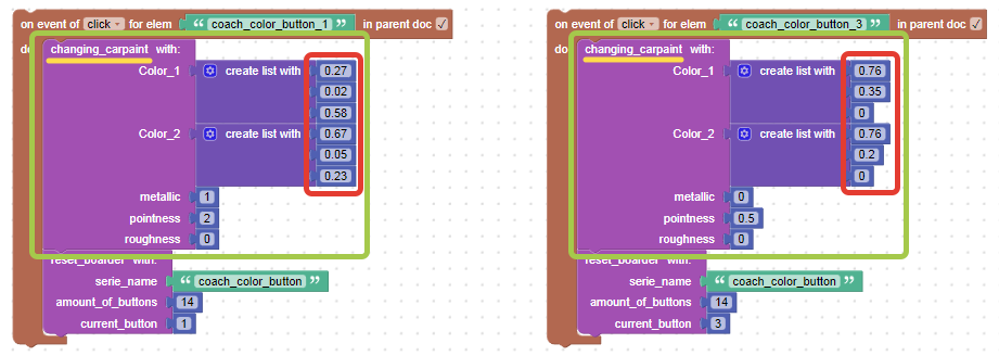

I’m trying to create a puzzle where colors change based on the RGB 0-1 values as done inside the scooter example.
But I can’t figure it out

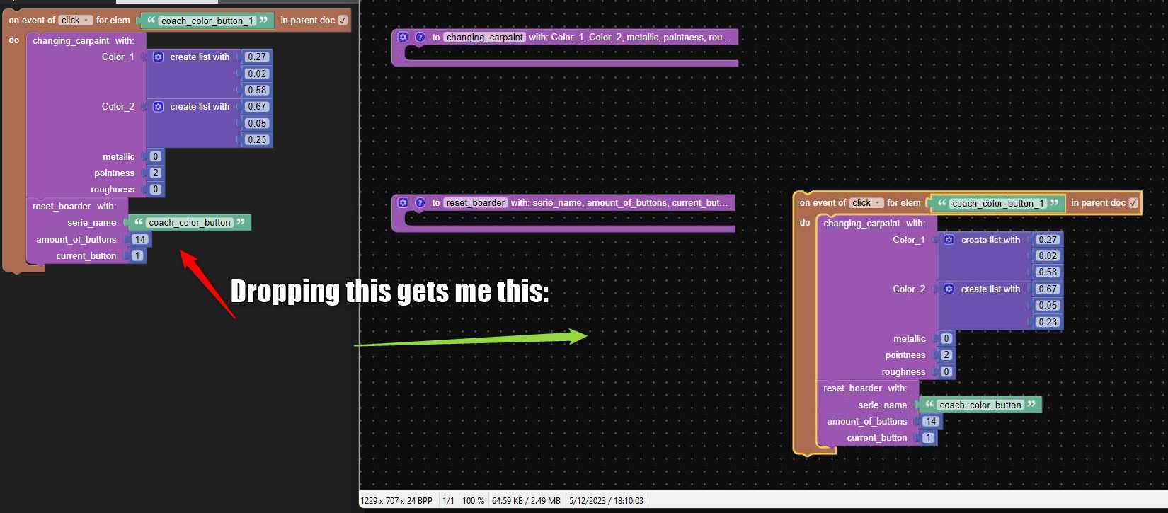

I tried saving some of the puzzle parts from the scooter to my library, but when I drop one part it adds some additional pieces.
I also tried to find a tutorial for that but couldn’t find one neither
Anyone here who can help me to solve this?Attachments:

Participantyou copied two function calls without functions themselves
https://www.soft8soft.com/docs/manual/en/puzzles/Procedures.htmlPuzzles and JS coding. Fast and expensive.

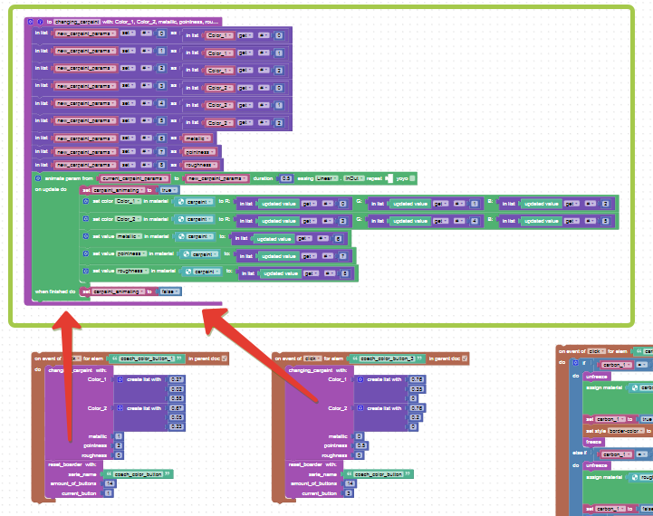

➤ Hyper-realistic 3D. Cars, Motorcycles, Products, Archviz Visualizations, 3D & VFX Animations2023-05-13 at 5:21 am #63746kdv
Participantthe procedure
changing_carpaintis called when you click one of the buttons
The procedure itself is at the top of the page. All commands needed to change colors are inside this procedure.
