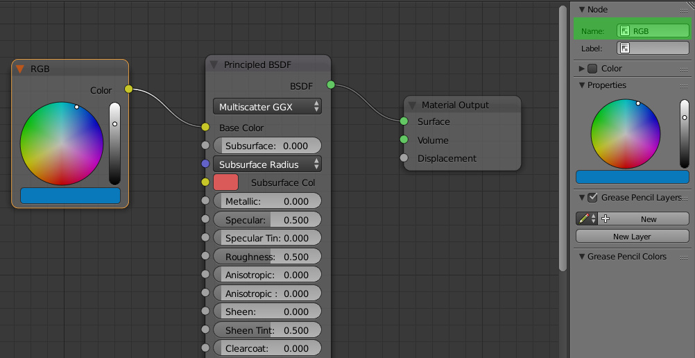

CustomerPrincipled
2018-10-04 at 2:38 pm #7873
Yuri KovelenovStaffThis API only works with a dedicated RGB node:
2018-10-04 at 3:04 pm #7875dragosburian
CustomerAnd the code remains the same?
2018-10-04 at 3:15 pm #7876
Yuri KovelenovStaff -
