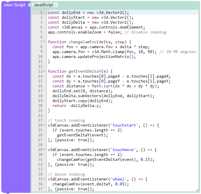

    I need the camera to change field of view instead of dolly when user tries to zoom. ( ineffective it will give a zoom feel itself, but i dont want the camera to move ).
    I managed to achieve this on desktop by detecting wheel and translating that to camera Field of view. I cant seem to find a way yo detect zoom in or out gesture in touch.
    Can you please help solve this ?
    Thank You
    #59518
    https://v3d.net/e6p
    #59527
    jasonod888
    Thank you !!
    Appreciate the time taken to respond.
    It works perfectly.
    #59531
    jasonod888
    Hi, Sorry to bother again.
    This works perfectly when I save the puzzle and run the project.
    However, the next time i try to access the puzzle from the App Manager I get a blank screen. I then need to use the backup .xml to access the puzzle. Thus im assuming the Java script is causing some issue with the puzzle. Any ideas on how to solve this.
    Thank You
    #59532
    Have no idea about this issue on your side (see the browser console log for details). It’s the question to the Verge3D team. On my side there are no issues with scripts.
    #59533
    jasonod888
    OK. Thank you for your response. I think the verge3D team will respond on this thread itself.
    #59534
    You can move this script to your_app_name.js, to the runCode(app) function.
    #59535
    jasonod888
    Uploading the .xml file for reference of the verge3d team ( hope it helps )
    #59540
    jasonod888
    Perfect. Works great now. Puzzles working and the FOV changes as expected.
    Thanks a ton !!
