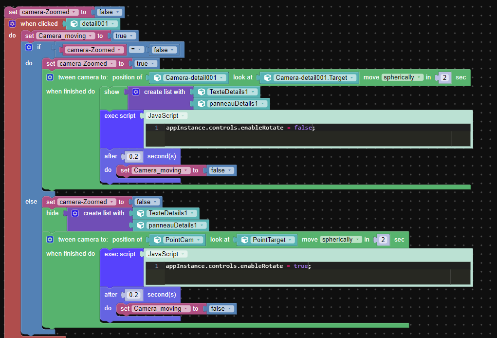

NaxosCGCustomerI’ve tried to put “appInstance.controls.enableRotate = false;”, after camera zoom-in, it works as the camera can’t move anymore, nice.
But then it seams that nothing can be clicked anymore, so i can’t click to zoom-out again…Attachments:
