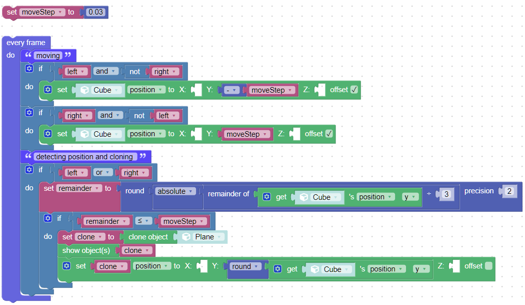

    https://drive.google.com/…/view?usp=sharing

    5 is a step, an interval between clones.
    The point is to detect positions multiples of 5. The problem is that while moving your cube will never be exactly at 10, it’s position wil be ~9.999999756 or ~10.00000156 and it’s hard to catch 10 exactly. That’s why a remainder is used to catch the desired position. It should be a very small value, less than the moving step.
    this logic will trigger cloning at 0.03, 3.03, 6.03, 9.03 etc.

    :scratch: :wacko: :unsure:
    #77485
    c4cc
    This works. Cloning is only done once, right, unless specified otherwise? Thanks again, I could use this code in the future for sure. :good:
