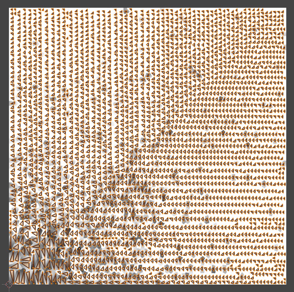

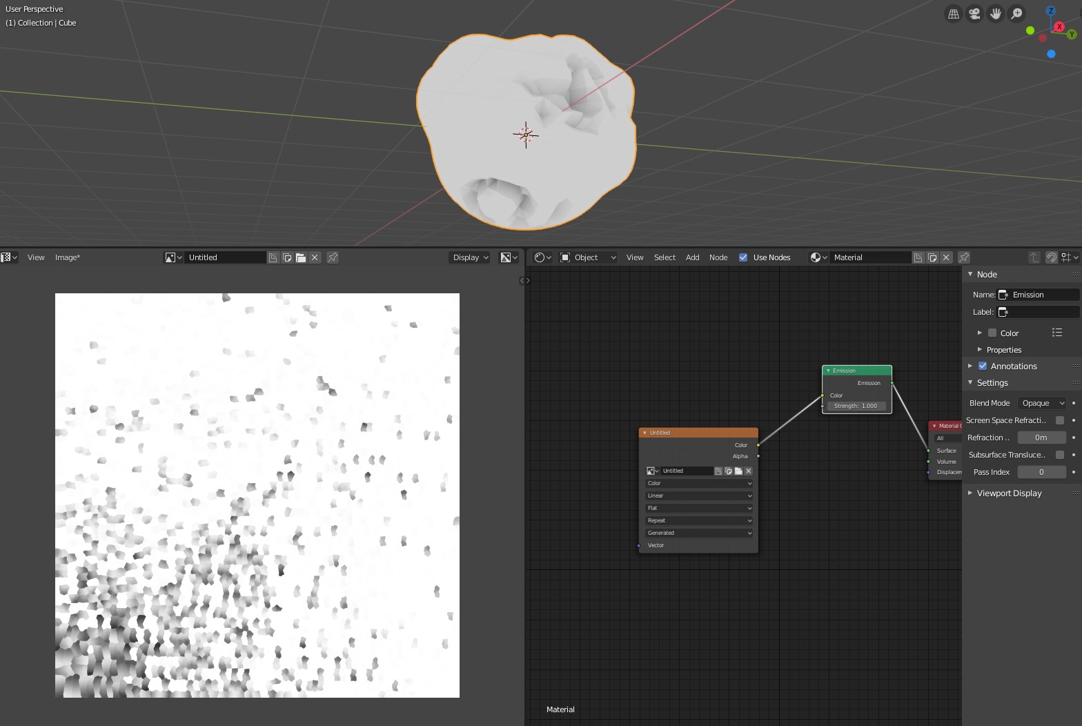

2019-02-14 at 5:58 pm #11445
Mikhail LuzyaninStaff
You can do a very rude unvrap by separating each triangle as individual piece on the uv-map just need to leave more space between them and make long margins. If you plan to make a retopology this will be a quick method to make a rought test of the scene to show the customer.
I know this example in Blender, but I think you can do the same in 3ds Max. It’s just easier and faster for me to make it in Blender.)Attachments:
