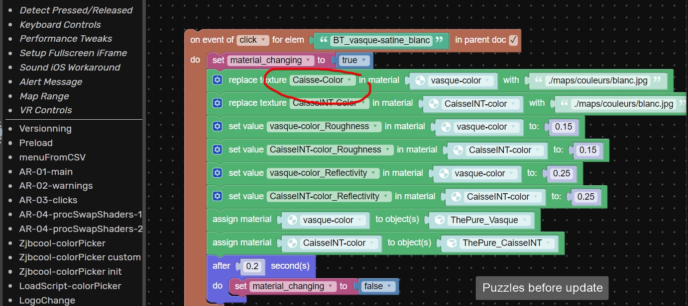

I have to rework an old project (2022-05, don’t know verge3d release used) to make AR available.
To be “sure” to get the best of Verge3D, i update the project (rounded green arrow in manager).Result is that it does not work anymore : changing colors (in fact jpg bitmaps) no longer works.

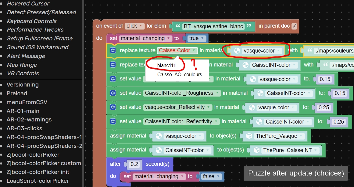

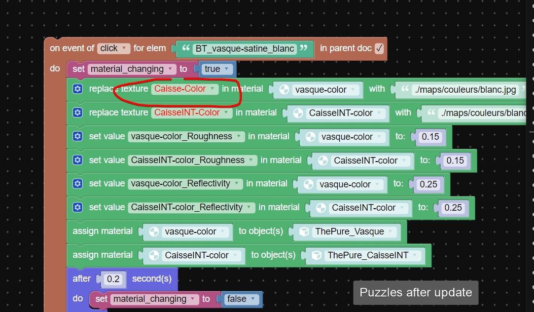

The reason is because i was refering to map name for material (“replace texture XXX in material YYY” puzzle), but in new release (4.4.0 pre1) it refers to another map name instead . Old map names are red, so not known anymore.Please see screenshots for explanations.

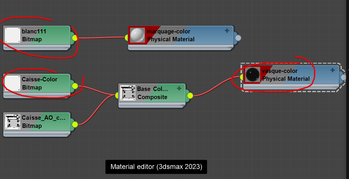

NaxosCGCustomerPrecision : both the “good” map and the “not good” one are referring to the same bitmap jpg file, maybe a track to follow ?

Alexander KovelenovStaffPrecision : both the “good” map and the “not good” one are referring to the same bitmap jpg file, maybe a track to follow ?
If you copy and rename the second file will it work as expected?
2023-07-06 at 12:55 pm #65024
NaxosCGCustomerIf i duplicate several times the file.jpg, with different names, and reaffect them to all materials that were using it, then it works.
But it creates more files that would be normally needed.So, the “issue” is that somewhere is coded not the map name but the bitmap name used instead, and puzzles refer to this.
