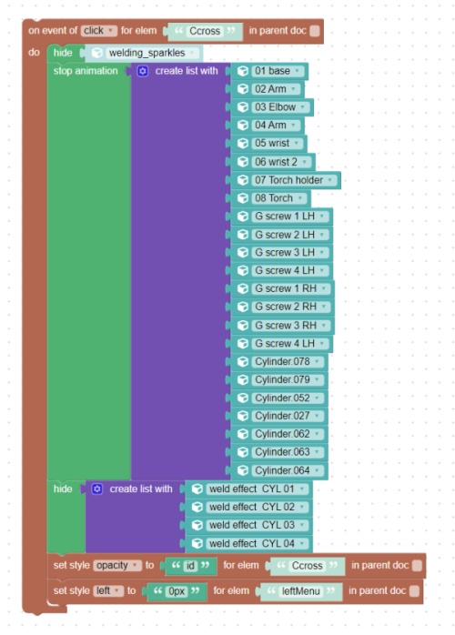

7. I added process termination by using “stop animation puzzle “clipboard1.jpg”. This is supposed to set all relevant animations to frame zero of mentioned objects in the list.
Now the Problem I noticed is –
Regular sequence works fine but when I click on the element which is supposed to terminate the ongoing animation and set animation to zero has unpredictable results. Sometimes it stops & some times it doesnt. Some times even some objects stop but some keep going on.
