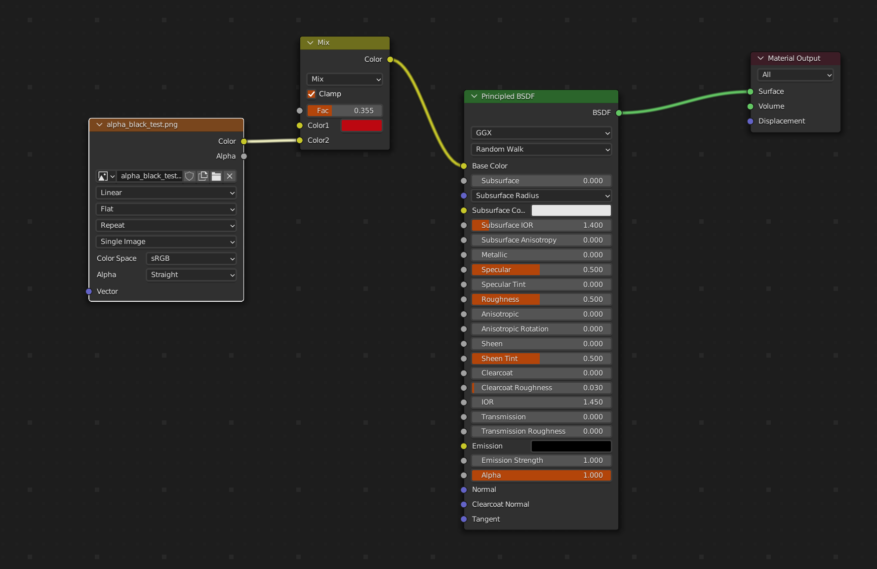

    I attempted a Principled BSDF with a simple node tree see attached.
    No issues mixing color …out put is as expected in V3D. Can you show a screen shot of your material nodes?

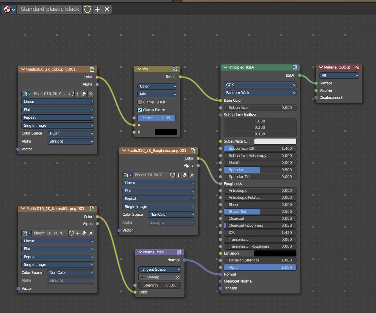

    vergecurious
    The one attached fails every time. Maybe it’s a blender issue?

    I created a version of your shader see attached and its working in Blender and in V3D as expected.
    Based on what you are trying to achieve there may be another issue you are running into.

    vergecurious
    I added a blender cube to the file. Applied the material I showed you. zip, zero, nothing. I’d send you the blend file but it’s too large.
