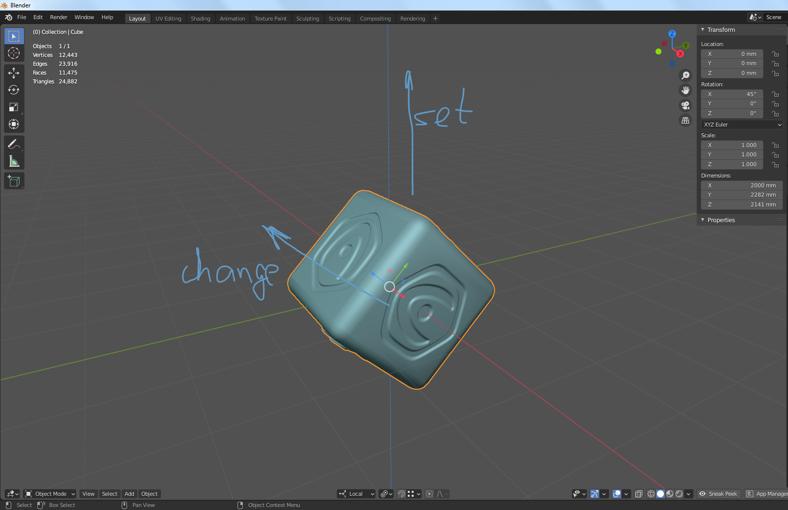

    “Set position/rotation” (with or without offset) works in the parent’s (or world’s) coordinates. “Change local position/rotation” works in the object’s local coordinates. Scaling in both cases works only in the object’s local coordinates.
    Watch this video to see the difference between the world’s/parent’s/object’s coordinates
