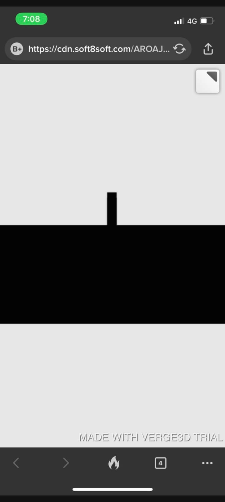

    My client has a black screen while viewing the project over the CDN. I have noticed it occurs only in apple iPhone and iPad. what is causing this problem ? I have attached below the screenshot for refernece

    I have reviewed the link and can verify that the problems you are having are happening to me as well.
    Recommendations:
    There is a noticeable reflection in stones that contains green. I would restest the scene with no environment map and a light source and see if the issue is related to the environment.

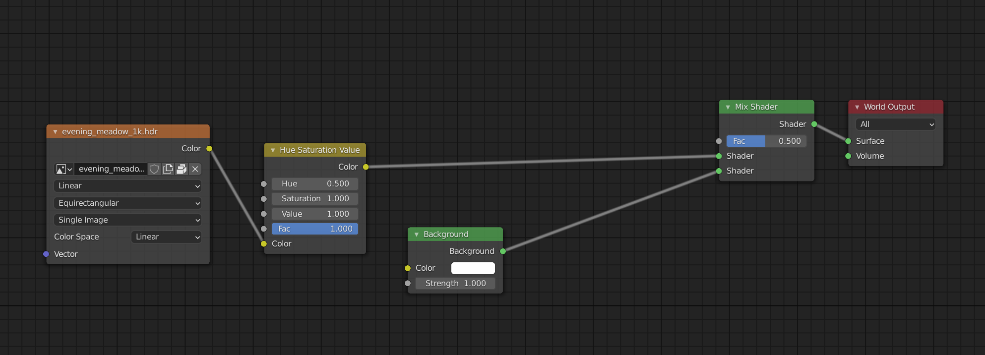

    https://cdn.soft8soft.com/AROAJSY2GOEHMOFUVPIOE:184ff32db5/applications/xeon_draft3/xeon_draft3.html
    The problem you are experiencing is that the World Environment Nodes you are using are not all supported.
    #46391
    to fix the issue…. I simplified the World Node….
    When creating complex materials you have to be sure each node is supported. I didn’t dig into it to find out which node or nodes were causing the problem.
    I can caution that if you are using a plugin to create the nodes you are better off doing it by hand and using only those that are known to work specified in the manual.

    From what I can tell you are using a plugin for textures. This plugin is creating non compatible materials nodes that is causing problems.
    I have removed all references to that and have simplified the materials.
    I also reduced one of your textures from 14.6Mb to something much smaller.
    You will want to get familiar with the compatible material nodes if you are going to use the plugin so you can go through and strip out those that will cause this issue.

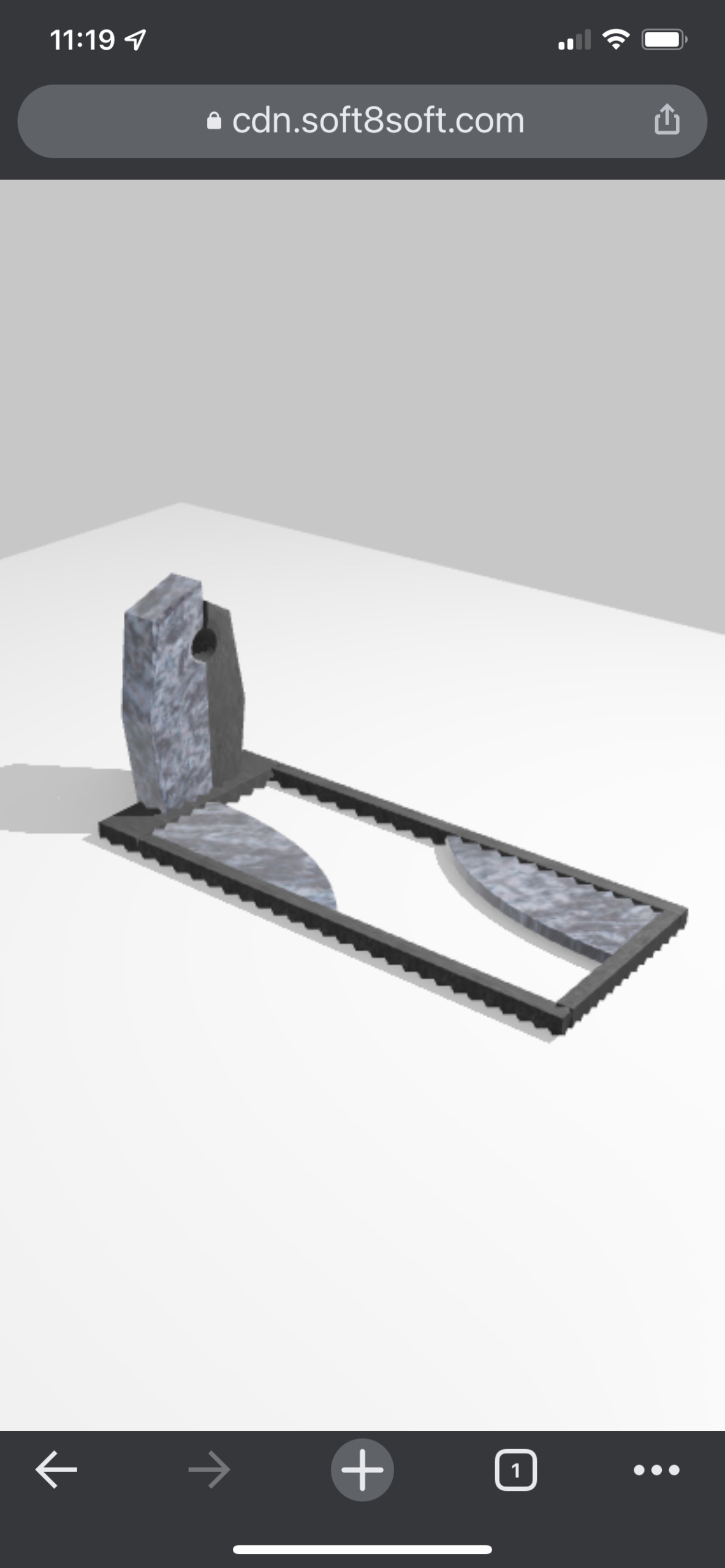

    You will also want to turn off ScreenSpaceReflections in Blender. If you need the effect I would recommend using light probes and bake your textures and shadows.
    Also, AO does not work well on mobile phones right now. There are lots of documented threads in the forums on this. If you need AO I would also consider baking your shadows and AO. It will look much nicer.
    Attached is a screenshot of it working on iOS 15.02 in Safari and a link to the project zip file with the required tweaks.
    https://cdn.soft8soft.com/AROAJSY2GOEHMOFUVPIOE:184ff32db5/zip/xeon_draft3.zip

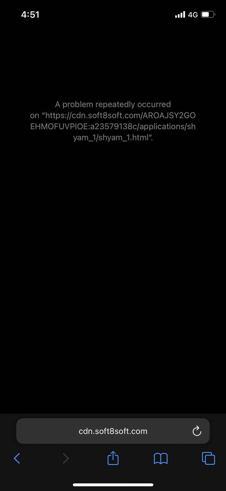

    While opening in safari in iphone12, it keeps reloading and throws this screen attached below
    only mentionable things are
    1) area lights are used
    2) materials has an emission value of 1 to avoid the white screening(fresnel effect).
