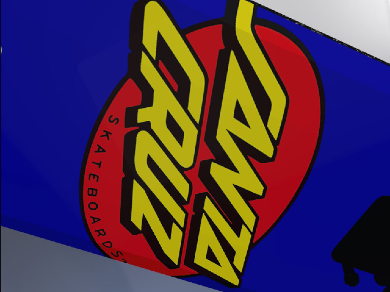

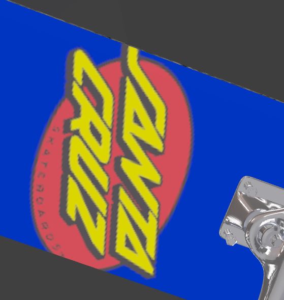

    I’m trying to export a model from 3dsmax to verge3d.
    When i export my project, all the textures are pixelised and White veil.
    I’ve attached 2 img the first one is the 3dsmax export (scanline) the second is the result in verge3d.
    Please can you help me ?

    You have used tiff file format for image, on export it converted to png and may be loose a quality, try to convert it to jpg or png file format.

    As I said before, the problem cause because of TIFF file format, change it on png or jpg to solve the problem.

    Great,
    Thank’s a lot
