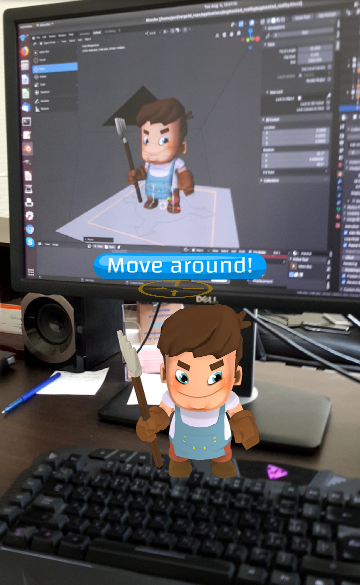

2019-09-03 at 7:50 pm #18397jem
CustomerI built my first AR demo from scratch last week using 2.14. It was relatively easy and worked nicely on a Pixel 3 running Chrome (after I set the developer flags).
I know that Apple has not yet incorporated WebXR into iOS Safari, but would it be possible to get a Verge3D-AR scene running on iOS in Mozilla’s WebXR Viewer app? I did a simple test using my AR scene (which is based on the Soft8soft sample code) and Mozilla’s WebXR Viewer app. My application reports that “AR is Unavailable”. Does anyone know if there is a way to make this work? Would overriding the checkARMode() function help? Thanks!
